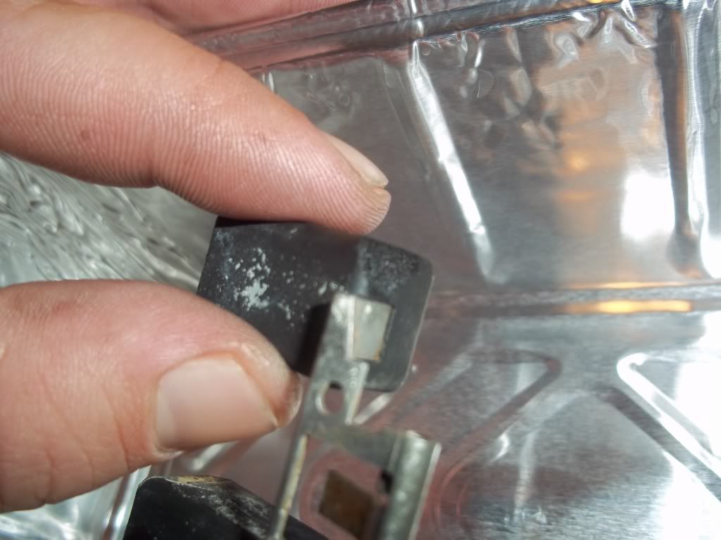

    Well Its all clean as can be now, one of the floats has a chipped corner on it, would that make a difference?
