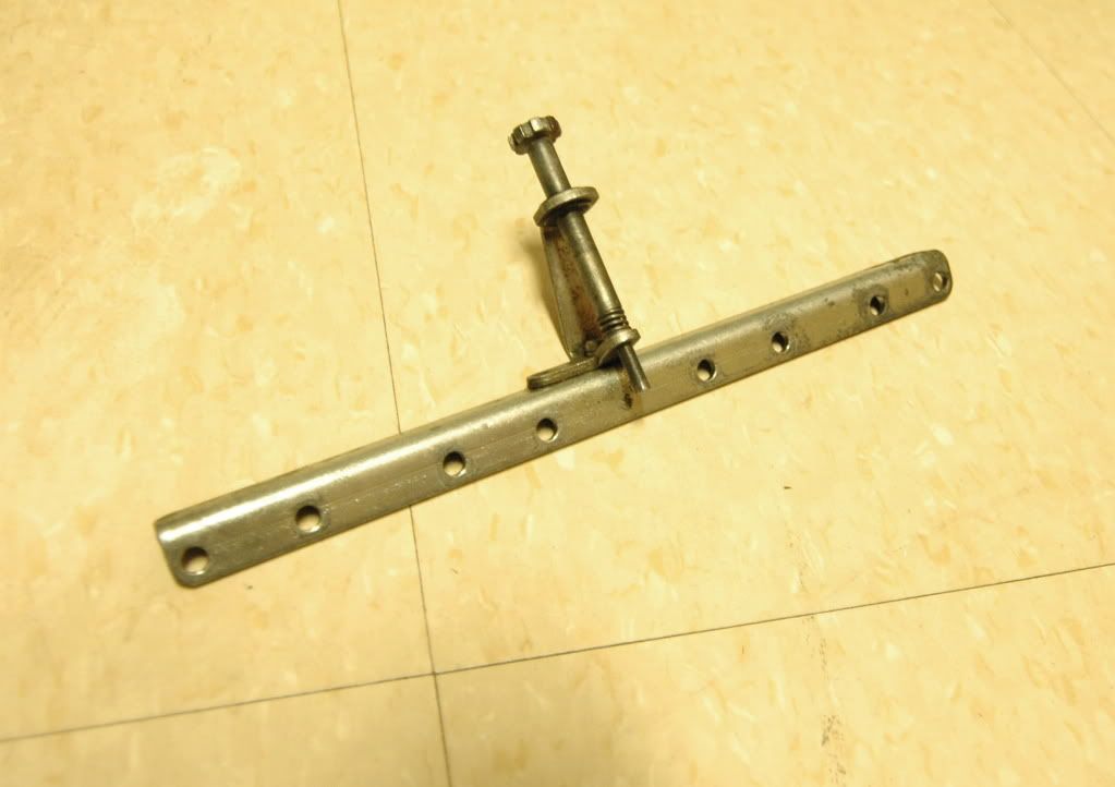

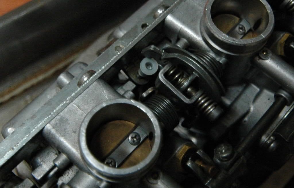

    These are the carbs without the idle adjustment screw attached.
    This is the idle adjustment screw.

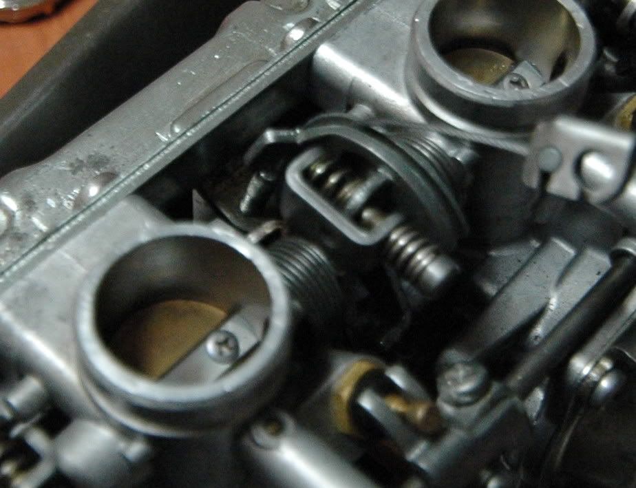

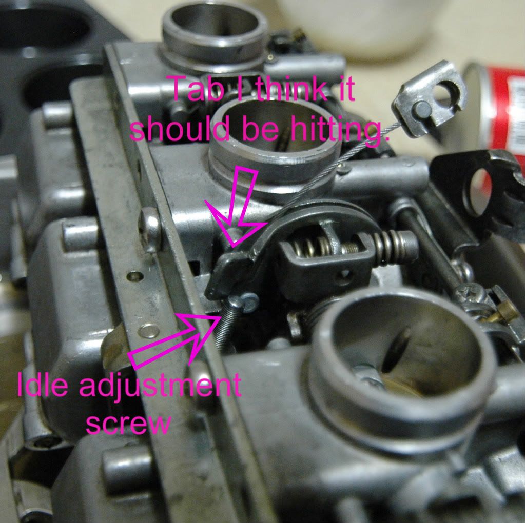

    Here are the carbs with the screw attached. Note how the screw is just to the left and below the tab, just missing it.
    Anyone have any ideas on what to do? I was thinking maybe the tab should be bent down more? If it were it would hit the screw dead on... I just don't know how to bend it without snapping something off. I checked to see if the the screw was bent, but it seems straight enough. I'm not sure if there's a piece missing or not, I'm sure a secured bolt on the end of the screw would be effective to push the throttle tab... please help me out, I'm new to this and kinda out of ideas at this point, unless I just didn't hook it back up properly?

    OK: I've got two 550s and two spare racks of Mikunis, so this isn't an "opinion" I just went and looked.
    That tab is supposed to be at 90* to the quadrant.
    Wiz, he has all of the correct parts;
    Somehow that tab has already become bent away from its original position. My concern would be that it will snap off when bent back.
    On all 4 of my examples, that tab is at a perfectly square 90 to the quadrant, and the screw pushes on the edge of it. Like I said, I would be very concerned that bending it BACK will break it off or weaken it to the point it will fail in service; I would say go ahead and bend it toward 90* just enough for the idle screw to engage the edge of it sufficiently then stop.

    By the looks of things, someone has already bent that because they ran into this issue before. Bending it towards 90 degrees looks as though it will move it away from the screw.
    I wonder if you aren't missing a spacer or have a spacer on the wrong side of something??

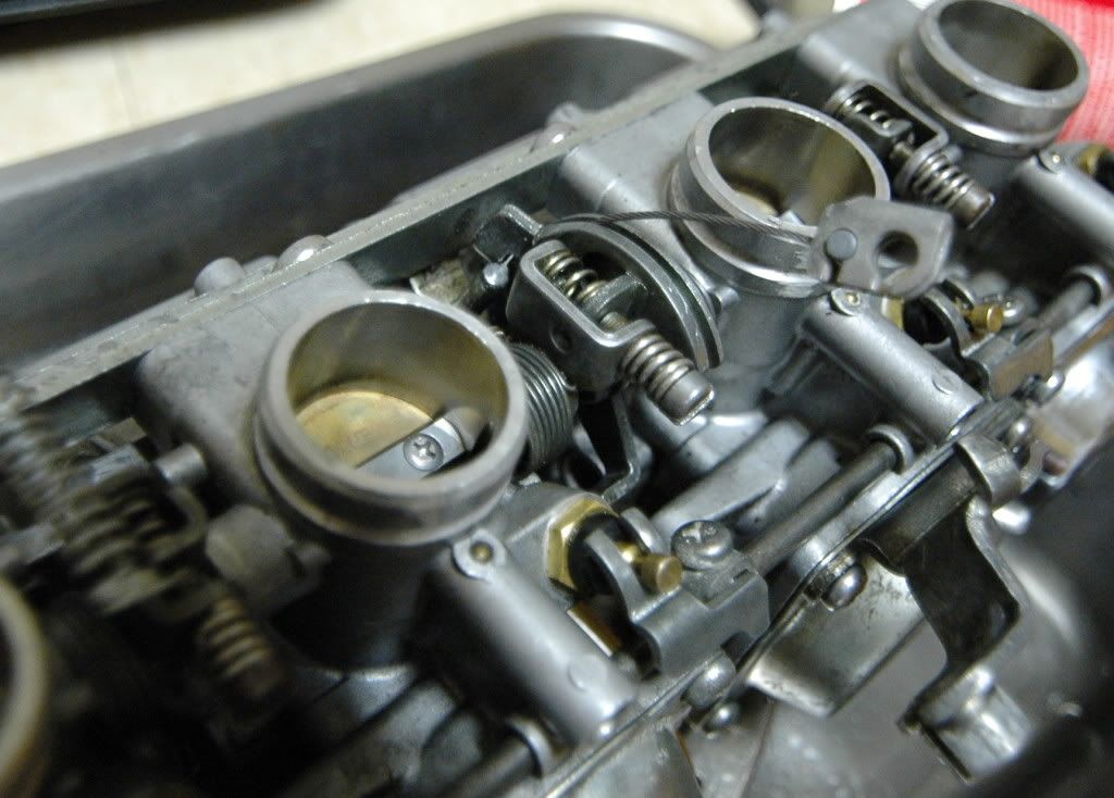

    Well, I went to the hardware store and got a nylon bushing which fit just fine on the idle adjustment screw and was able to push the throttle lever as seen here:

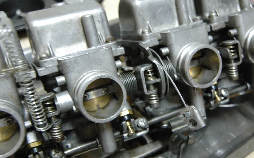

    But then, I read the most recent posts and decided to give bending another try using the tips bigfitz suggested with great success:
    As you can see from the picture above, I was able to bend the tab down enough to get the screw to push the throttle lever securely to the desired position. I'm glad I was able to bend it, the nylon worked well but this seems like a more durable solution as long as it doesn't bend back (although I don't see why it would).

  17. bigfitz52
    It won't bend back. If YOU didn't bend it (and we do believe you, honest) then a numbnuts PO or some goofball he paid bent it for gawd only knows what perverted reason.
    As long as the lever is acting on it securely through its very small necessary travel (fine-adjusting the idle) YA DONE GOOD.
