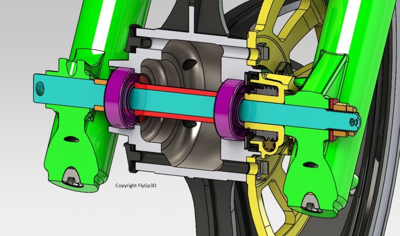

  8. FlyGp
    FlyGp Member
    130
    Michigan
    Maybe this will help; this is the XJ650 cutaway.
    From the right I have
    The castle nut, Washer, fork, speedo housing, bearing, wheel hub….
    FlyGp
  9. FlyGp
    FlyGp Member
    130
    Michigan
    One thought, were the wheel bearings changed? If the internal spacer (red in the picture) was left out the force on the speedo side bearing could push the rotor toward the fork leg. At the same time it destroys the bearing.
    FlyGp

    Fly, That full section is AMAZING!! I've seen some of your other work around here and you are truely talented. I've done machining and am currently working on two associates in CAD Design and Manufacturing Tech then a bachelors in I have yet to decide :). Big hats off to you Sir.
