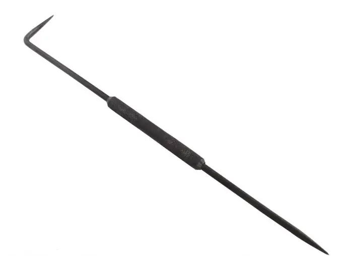

  3. bensalf
    bensalf Well-Known Member
    1,369
    285
    yorkshire ,england
    get a metal scriber, like this one, and use it in the circlip holes progresively prising the clip in and out , on both sides to free it up. before using the circlip tool. also push the plunger in whilst dooing this to let the tool points go further through the clip holes

  4. k-moe
    19,654
    6,757
    The issue is the depth of the clip in the bore. A long-nosed tool is best, but a pair of awls will do in a pinch.
