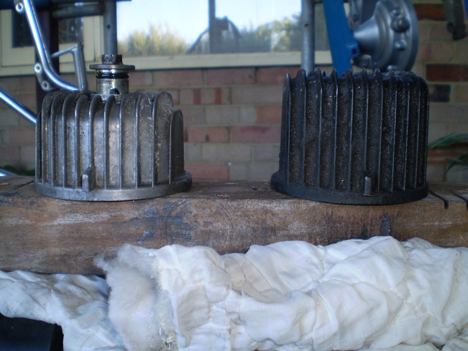

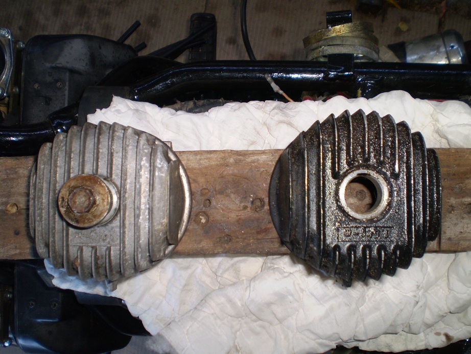

    I have the oil cooler from an XJ900 and a XJ750 to compare. See below pics.
    The bolt is longer also but the 750 cover has the same dimensions but I'm guessing the 900 filter must be larger.

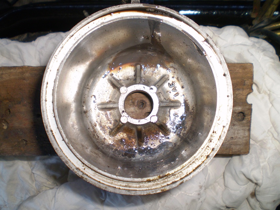

    Strangely my XJ900 cover is cracked around the bolt also.
    The taller one on the right is the XJ900.

    I'm not convinced that those are actually cracks. I have had many that look like that, but the are just casting marks and not really a problem. Unless, of course, you know for a fact that they ARE cracks :)

    I think the XJ900 cooler is a couple of rows taller than the 750 but this is a conclusion I came to from looking at some pictures when I was adapting the 750 gear to my 900 motor.
    Dave, as far as the crack is concerend... good point I don't actually know if it leaks as it just came like that in a box of bits. I'll have to give it a clean and take a better look one day.
