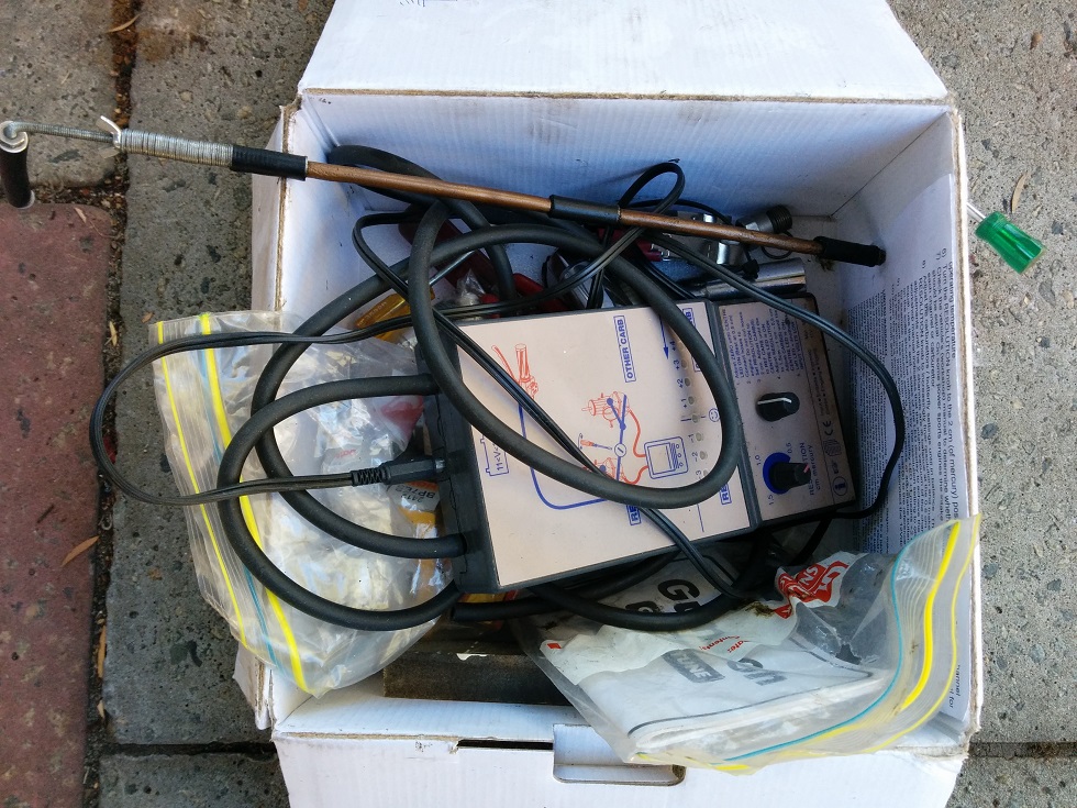

  6. cds1984
    cds1984 Well-Known Member
    1,053
    249
    Perth, Western Australia
    Blocking the YICS when your syncing and tuning, makes a HUGE difference to vibration at high rpms... so technically you don't NEED to use it but do you want a smooth ride or rough ride?
    The YICS normalises between the carbs and it makes it hard to differentiate which carb is doing what. You might be fiddling with #1 and its really #3 causing the issue...
    At any rate, take a look at my tune kit... I just keep it ready to roll and it makes me happy when I do a tuneup.

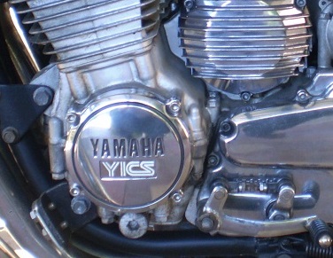

  20. TheCrazyGnat
    TheCrazyGnat Well-Known Member
    685
    323
    Central PA
    Maybe we can make a standard: White out the YICS lettering on the engine side covers.

  24. cds1984
    1,053
    249
    Although... you do realise the YICS badge is just a badge. So you can peel it out of the side cover.
    Then you can get your metal stamps out and smack in NO-YICS or YICLESS or FREED FROM THE BURDEN OF YICS (bit long maybe).
