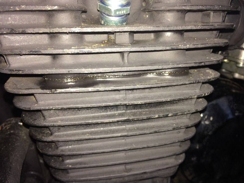

    So good news and bad news. I finally got the carbs figured out. It turned out all that was wrong was my floats were way off. Got them adjusted to 3mm on all four. Threw them on the bike and viola, good to go, right? No. After letting it sit idling for around 10 minutes, I figured the smoke was from the exhaust system being freshly painted (forgot to update a little while back, muffler was broken in half, welded it all back together and coated with exhaust paint) and it being the first proper start in the last decade. Shut it off and let it cool for 30 minutes, then fired it back up again. Let it idle for another 10 minutes and it was still smoking bad so I shut it off and noticed the head gasket was bubbling oil pretty much all the way around the whole gasket.
    Also when I changed the oil, there were metal flakes in the oil that I had high hopes were from the transmission, but with that and the leaking headgasket, it's looking like it makes more sense to swap the YICS motor from the second bike instead of tearing this one apart.

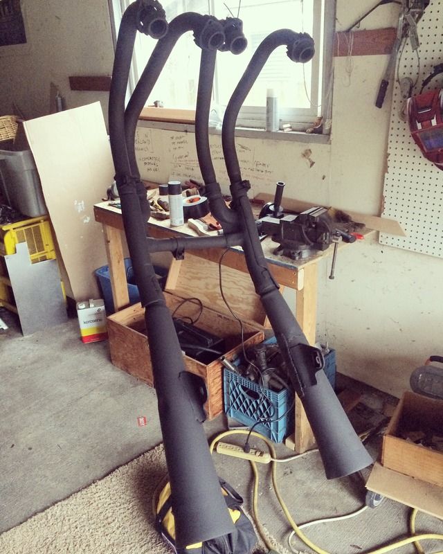

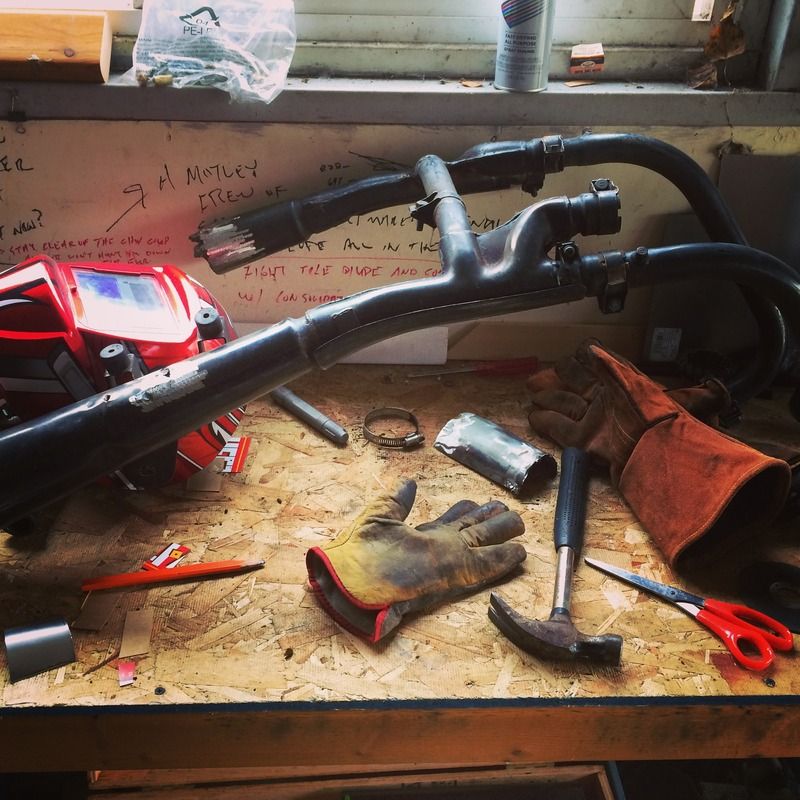

    On the bright side, I got the brake master cylinder and caliper rebuilt, so theres that (no pictures unfortunately, . Also, here's some pictures of the exhaust work that I never posted.

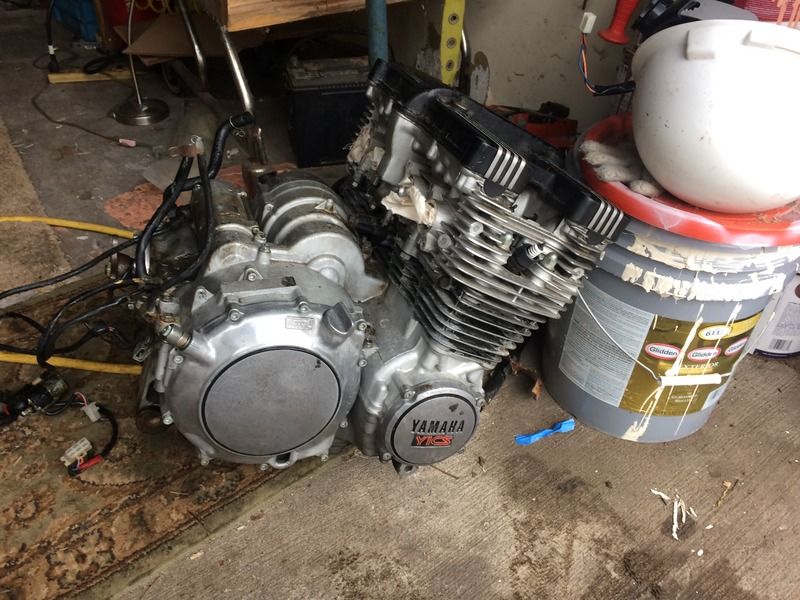

    So I started getting to swapping the YICS motor in. Pulled the YICS motor out of the '82 in my yard before the Superbowl started. Threw down a blanket in the yard and took it out with the bike on its side
    Cleaned the engine up with some degreaser and a wire brush and figured I should check the valves while I had such good access.

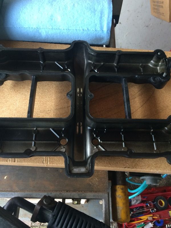

    When I pulled the valve cover, I found that the timing/cam chain was loose enough to score the top of the valve cover.

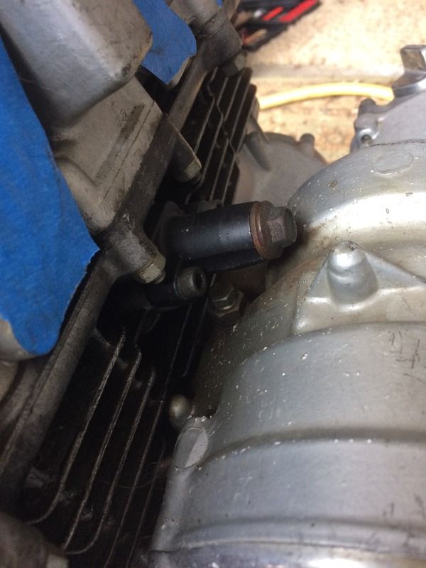

    The engine has an automatic cam chain tensioner, is this a part that tends to fail or is it more likely the chain stretched too much? Is it a direct replacement to take the manual chain tensioner from the '81 engine and throw it on there? I'd honestly prefer a manual tensioner if possible, for the same reason I prefer locknut and rocker valves.
    Procedure to take the tensioner off is set the engine to TDC on piston 1 and then just pull the thing off? Here's a picture of the tensioner I'm working with.

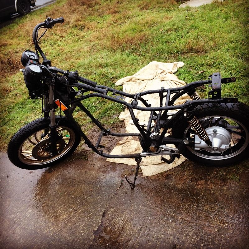

    Today consisted of stripping everything off the bike to get ready for engine removal, driveshaft u-joint bolts, CDI/rectifier plate, battery and box, airbox, exhaust, carbs. Unfortunately, up here in Seattle we got a bunch of snow on Monday so pulling the second motor will have to wait until the snow clears up.

    That is an expensive piece of kit for something so small! I'll pull it off and see if it's the guide or the tensioner that's the issue. Any idea if I can direct swap a manual tensioner for the auto one that's on there? It looks like I can, but I'd be a whole lot more confident if I'm not the first known person to try.
  12. k-moe
    19,697
    6,787
    The earlier manual tensioner is a direct swap. The auto tensioner may just need to be taken apart and degunked/reset.
