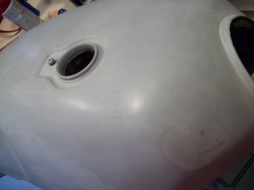

    Been a busy boy, making parts lists for chacal, sanding, priming, sanding, painting, sanding.....AAAARRRGGGGG! I would have become a professional body repair guy if it weren't for all the damn sanding you have to do.

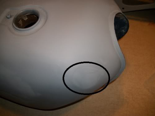

    Remember the tank with the 2.5" dent that was 1/2" deep?
    Well, finally got that all taken care of, along with 3 coats of primer

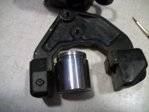

    I really wish I would have had a helper on the calipers, just to take pics. There was a lot of rust and water in this system for the lines being as new as they were. Can't wait to get this thing going so I can make it stop. Should stop on a quarter after a complete rebuild with stainless lines.

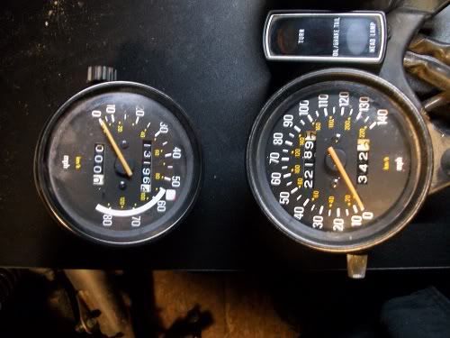

    In between coats I had been looking for some new(er) gauges.
    These kinda suck
    Snagged a set off fleabay for a '78 750 Yammie for ten bucks.

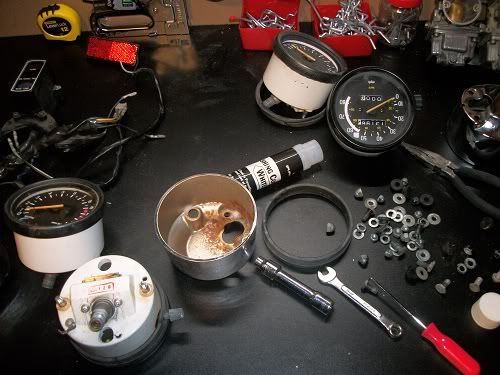

    Then the surgery started

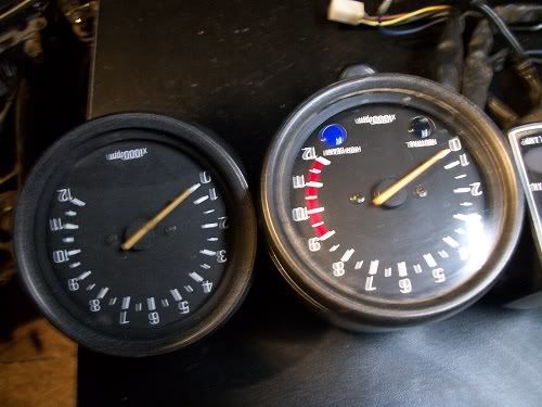

    New speedo is on the right... 85MPH will be gone shortly!
    New tach (with glass that I broke last summer) on the right. Nice and bright compared to the old one.
    Time for a drink in the middle of surgery so I snapped a quick pic of the workbench. Yeah, it's under there somewhere.
    And time for a beer well deserved. Install completed!
    The new speedo has 22,000 on the clock. I haven't decided if I want to chance breaking the glass to get at the guts to reset the mileage. If I do I want to reset to 0 so the 650R can start it's life anew.
    The tach has non-working high beam and neutral lights, which doesn't bother me. But there are two holes at the top for white light, so after checking them with a multi-meter and a battery, I spliced two into the old harness. Should be easier to see the tach at night now.

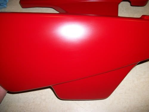

    And here's the work I've done on the tins so far. Tank isn't cleared yet, so those pics will be posted in about a week.
    Front fender
    Oops. I forgot to wipe the dust off before I snapped the pic
    Rear
    Sidecover

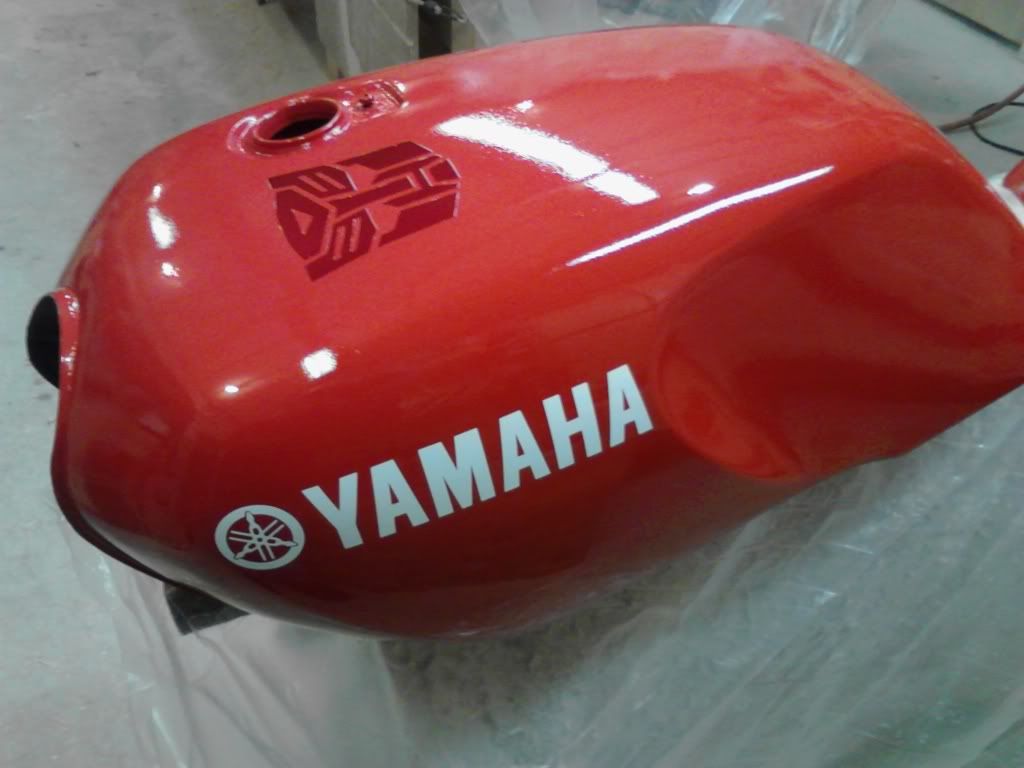

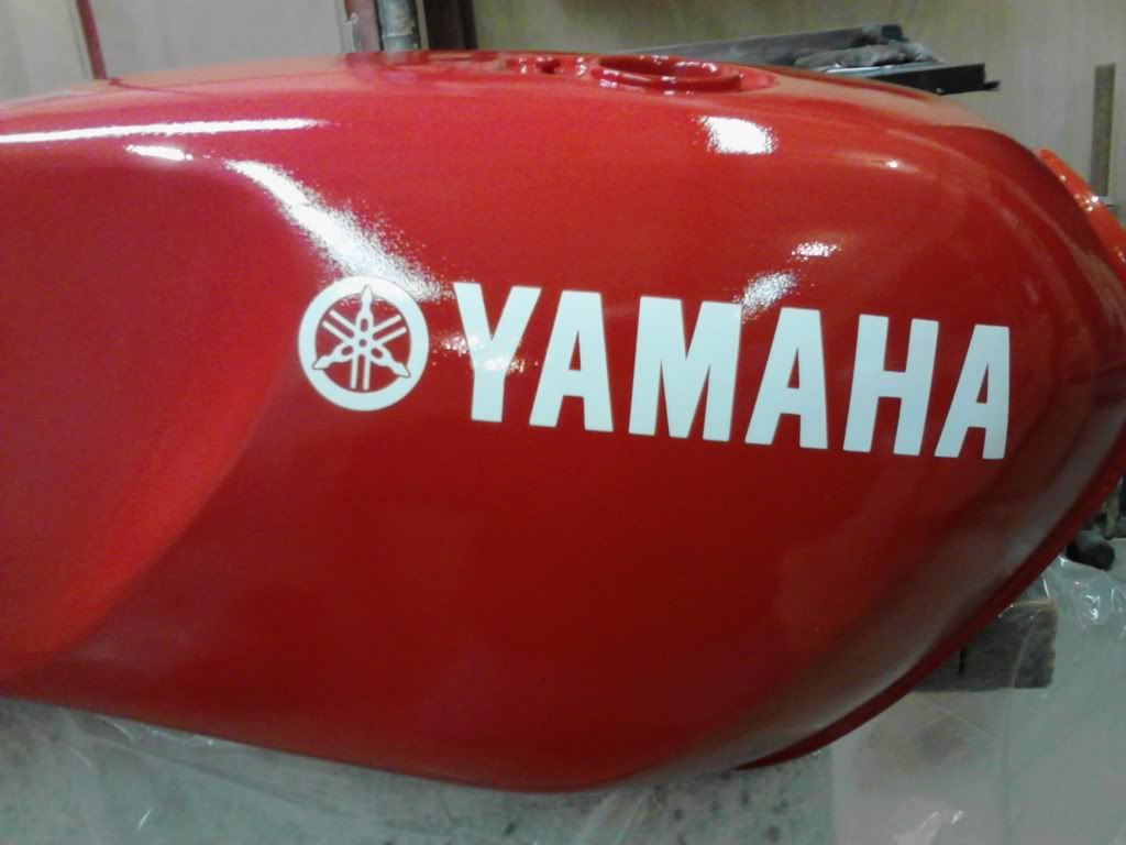

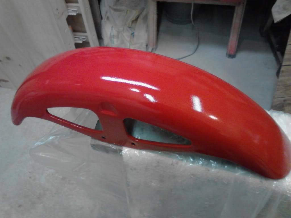

    Front fender, 3 coats of clear
    Tank after 3 coats of clear
    Sorry about the size of the pics, still haven't found the camera so I had to snap these with my phone.
    Will post better pics after the tank is wet sanded and re-coated and buffed.

    Using rattle cans of Duplicolor Torch Red (late 90's Corvette color match) and Spray Max 2K clear coat, which I can now HIGHLY recommend for clear coat (Petrol safe too!)
    I actually did more coats, just that I sprayed 3 coats before the first wet-sand.
    The order I did was:
    bondo, 80 grit, bondo, 120 grit, spot putty, 150 grit, spot putty 220 grit,
    Primer, 400 wet, primer, 800 wet
    Color, color, color, 400 wet, color, 800 wet, color, 1000 wet, color, 2000 wet
    EDIT::: Forgot to add that the decals go on HERE. OOPS!
    clear, clear, clear, 2000 wet
    still to do: rubbing compound, then polishing compound. Hand buffed with microfiber detailing towels.
    I'll have good pics of the final result up tomorrow. Have to wait about a week to see them on the bike though, bench sync and wet-set carbs today.

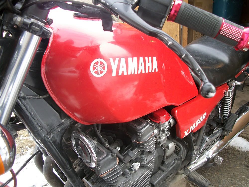

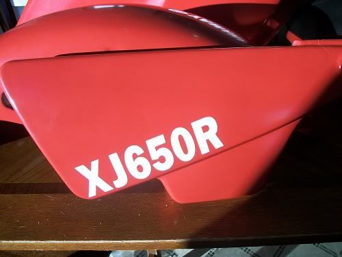

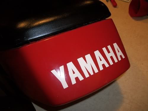

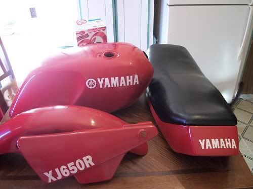

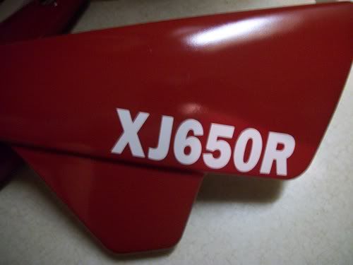

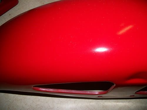

    All painting is done. These are what the tins look like after hand buffing with the rubbing compound. The color didn't come out exactly as I had imagined, but it's pretty close.
    These are the custom decals I had made for the side covers
    Crappy lighting in the kitchen doesn't do the paint justice. I might go back to the in-laws with the tank just to get a couple of good pics for my file.

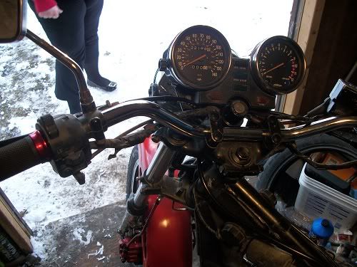

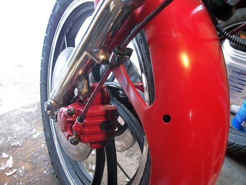

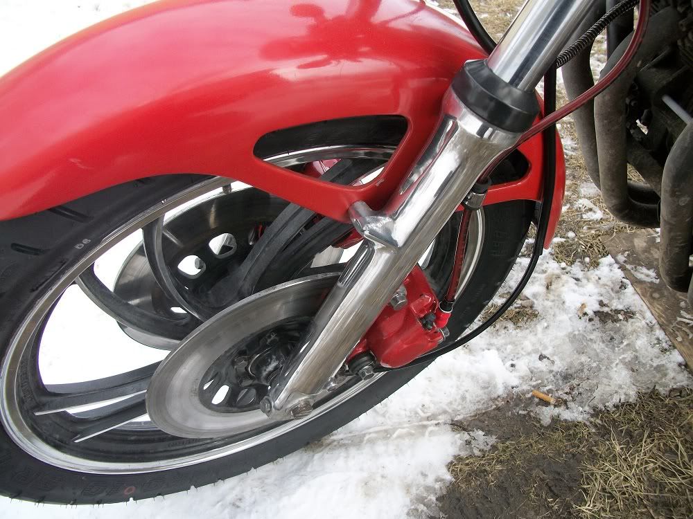

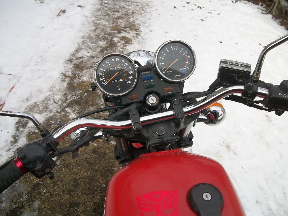

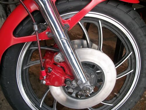

    Got the handlebars in the mail today, didn't expect them until Tuesday. BONUS!
    So I got the front end buttoned up today.
    New bars, the MC fits now, but I should have went with 26" instead of 29". But they'll work for now.
    Left side, showing the new stainless lines in red sheathing.
    And the right side front. New Shinko 712, calipers painted, lines installed and brakes bleed in 15 minutes, forks polished and buffed. Oh, and the road rash on the forks... not my fault.
    I'll have some touch-up on the paint to do this summer.

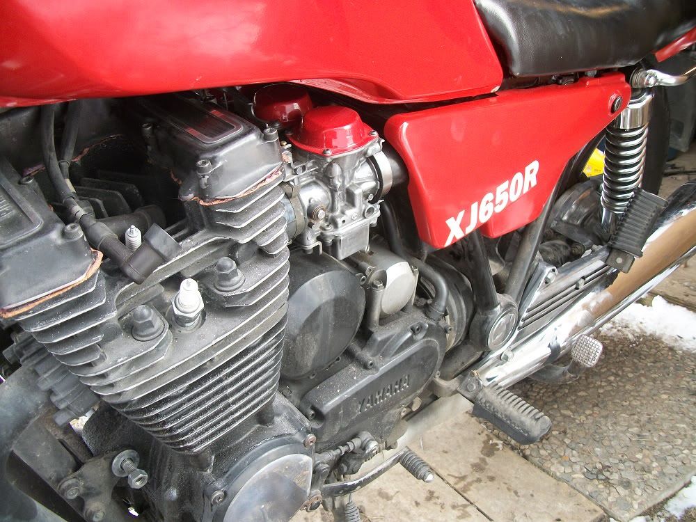

    Thanks Grunt. The 650R Seca came stock with round gauges and headlight, although the original was an 8", and the one I have on there now is a 7" unit from an XJ550 Maxim.
    The gauge housings are the stock cans, with internals replaced by units from a 1978 XS750. They were much nicer looking than my sun-faded, 85MPH stockers.
    I'm still waiting to rebuild the petcock so I haven't had her running yet, but the feel of the lever just moving her around in the shed so I can get to the rear I could tell a night and day difference in the front brake.

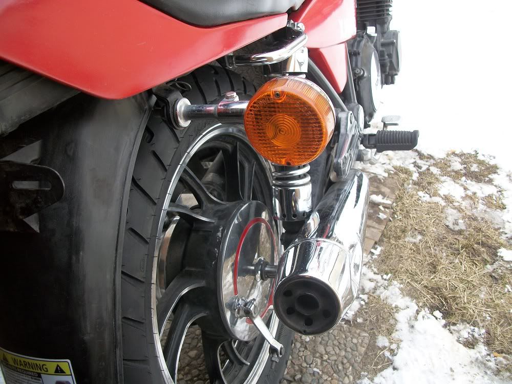

    Rear fender is off.
    Rear shocks replaced with slightly used 12.5" units from a Harley-Davidson.
    Tomorrow morning the rear wheel, gear housing, and brake backing plate will come off for another round of polishing.

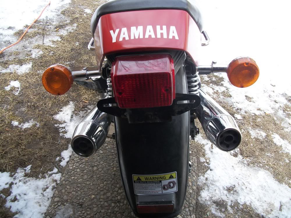

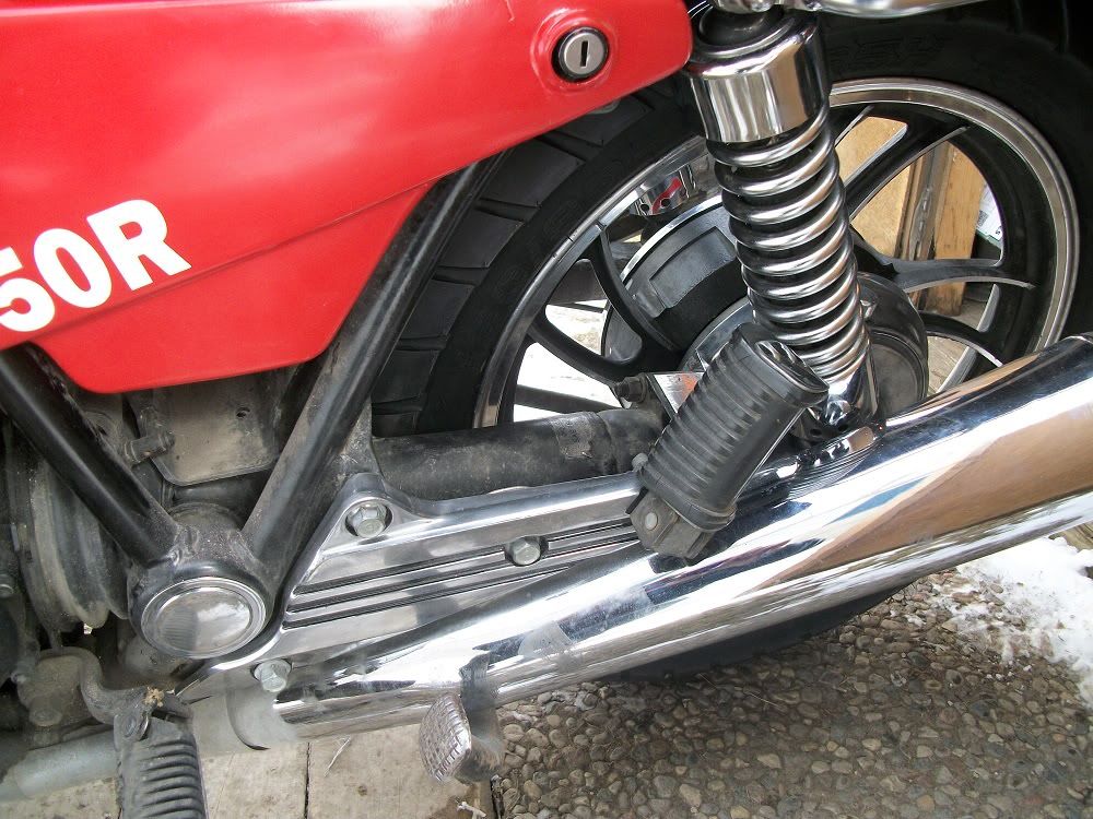

    Got some polishing done. Having a heck of a time with the gear housing though. That might take a couple days.
    If you would like to see the warning on the rear fender......PARENTAL ADVISORY: Explicit Language

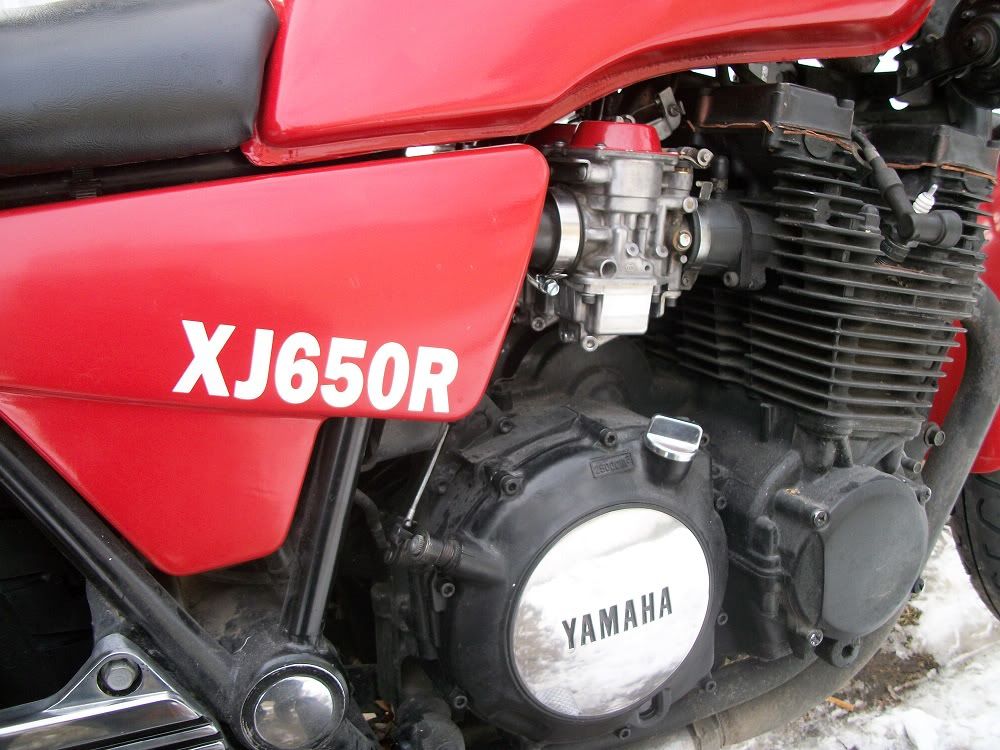

    Well the Seca is nearly done.
    List of to-do's is very short.
    Rebuild petcock, fuel and vacuum lines, fill with fuel, install battery, new plugs, running sync, colortune, hook up front signals, test ride.
    Here are some pics, although the tank is back off the bike so it doesn't draw condensation outside.
    Will also be getting some black tank seam edging, new footpeg rubbers, new brake and clutch levers, and new fuse block to clean that area up. The inline fuses don't look very clean.

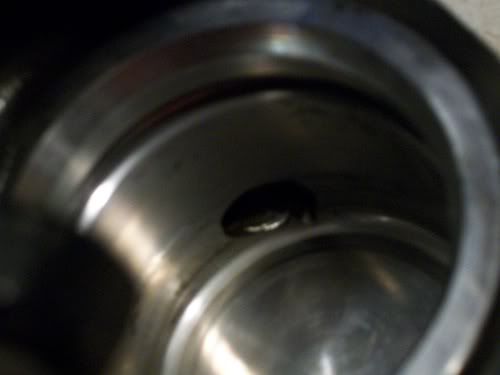

    I got a package from Len yesterday, proving once again that he is the man. The package was here 53 hours after I sent payment.
    Included in the package was:
    Deluxe petcock rebuild kit
    Front footpeg rubbers
    14mm colortune
    Ball valve for the gas cap
    After installing the ball valve in the gas cap and the rebuild kit for the petcock it was time to get some fuel and ATF and go to work.

    It started on the fifth try. After letting it warm up a bit I shut it down to check the oil level, look underneath for any leaks I didn't notice when it was running, and hook up the sync gauge.
    After syncing it was running quite poorly. I went through the colortune on one through four. Runs perfectly now....almost.
    The problem I am having is that after the sync and colortune the bike is idling around 1400RPMs. The problem with that is after adjusting the idle during the sync my idle screw no longer touches, so no amount of backing it out will make the idle drop.
    The idle isn't erratic, blip of the throttle brings it immediately back to 1400, I just couldn't get it figured before I lost daylight yesterday.
    I'm going to do another round of sync/colortune today, but if anyone has suggestions of what else to look for, I'd appreciate the advice.
    What I have done:
    Valves in spec
    Carbs 110% cleaned
    New gaskets
    New o-rings
    New seals
    Clunk test
    Float heights set wet
    Bench sync with business card strips
    Manifolds all good
    needles, seats, floats all good
