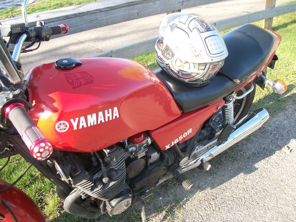

    Installed new shaft seals, did a running sync and carbtune.
    Had to start another thread about a rich running #4 cylinder. Had to charge the battery, so that's all sorted out.
    Tomorrow is a re-sync and colortune, hopefully the last time for a couple months depending on mileage.
    Also had to hook up the old tach for the sync. The tach I got from a '78 XS is a little slow to respond to the throttle so it looks like I'll be doing a disection tomorrow night to get that lubed up.
    Then after all that it'll be time for a ride to test out those new brakes and tires.
    Will post some more pics when I get her out on the road.

    Put a few miles on her today.
    She runs awesome, and stops even better.
    Coasted into the drive at home after a 5,000RPM plug chop.
    1,3,4 were a lighter grey, 2 was tan-gray.
    slightly lean, so a minor adjustment tomorrow then it will be time for another plug chop.
