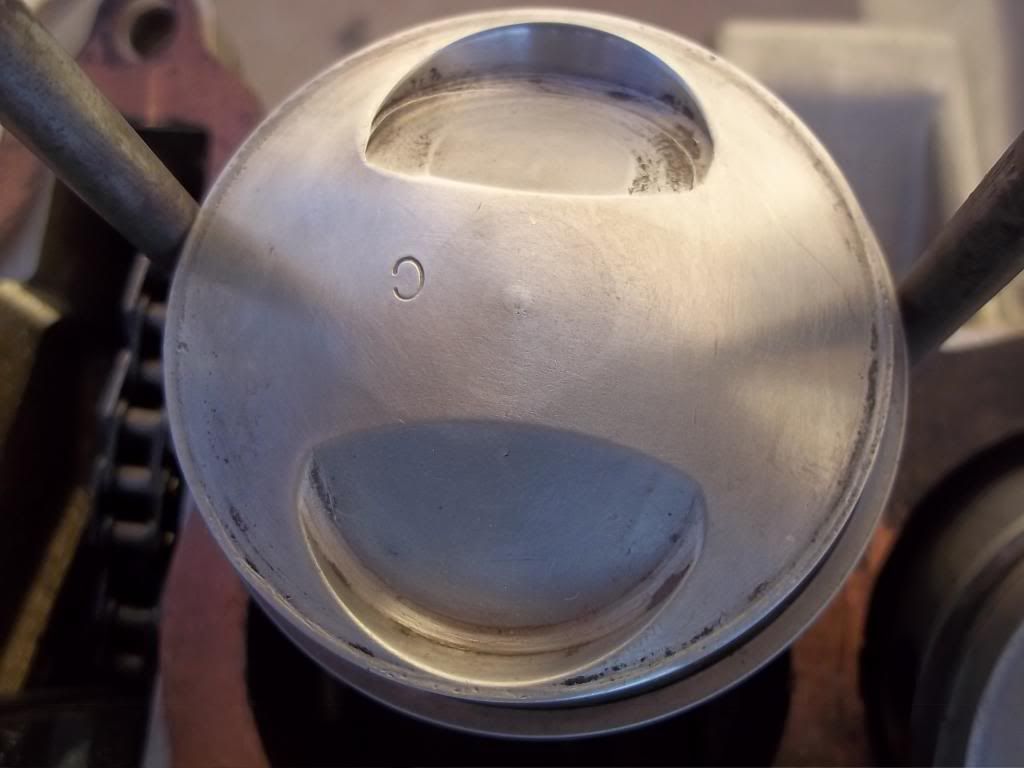

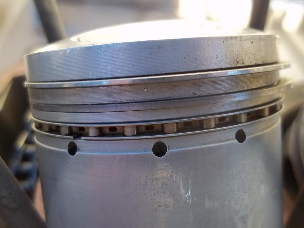

    Back in the day Wiseco did make a big bore kit for the XJ550/600.
    I met a guy that had a hot rod Seca 550 back in the mid eighties. He told me that his bike had a 60mm Wiseco kit in it.
    I might have one of those kits on my hot rod Seca motor that I broke a ring on. I need to send pics to Wiseco and see. Heck, I could send them a piston and they can copy it!
    BTW, these pistons are 60mm not 61 as I stated in this thread.
