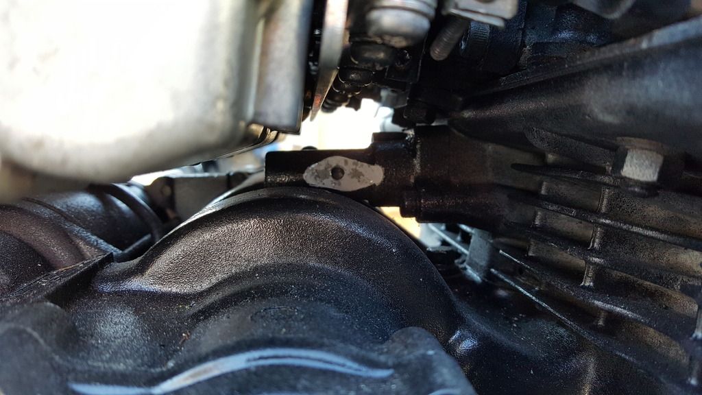

    Oh the fun I am having at the moment...
  25. hogfiddles
    15,112
    5,357
    Ay-uh.......
  26. saftie
    1,121
    285
    New York, NY
    I think I need to rethink the term "reset"...

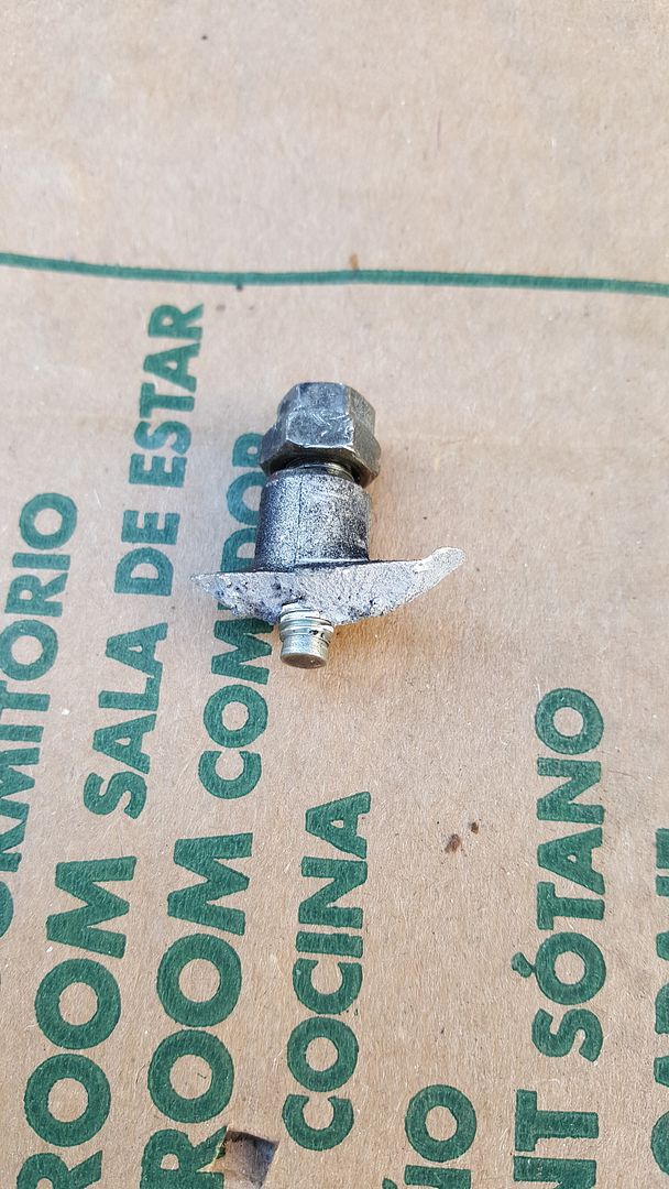

    Len came to the rescue and a replacement part, including gasket and o-ring, came by mail today. Monday afternoon ordered and it's already here. Love it. Thanks Len.
    Bike is hopefully put back together on Sunday.

    I haven't really looked at an exploded view of the engine, especially the cam chain tensioner. But if I tighten it by loosening the bolt, why the bolt at all?
    Know what I mean?
  29. k-moe
    19,697
    6,787
    To keep the plunger from being pushed backwards when the chain is being affected by the power stroke. If the plunger can move the chain will go slack. The spring makes sure the tension is correct; the bolt locks it in place.
