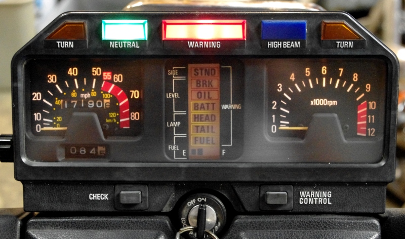

    However, the center instrumentation display is not functional. Found this pic on google, not my bike but cool to see working for the first time.
    http://4.bp.blogspot.com/-kb-7tXo0PuQ/TjTLpQo1D2I/AAAAAAAAAEU/HhIice5PUNc/s1600/atari.JPG
    Basically all the warning lights do not light up and the check/warning buttons do nothing. Neutral light works, high beam light works, and I forget but I'm pretty sure the dash illumination works. Another weird thing is the horn sounds like it's struggling to make a sound unless I have the battery connected to my car. In fact everything seems just a bit weaker than when connected to a car battery. Maybe just needs to run for a little while to shake off the dust? Or bad stator which I'll need to research and learn electrician stuff about so I can finally understand all the threads about resistance, ohms, and other mystic motorcycle mechanics.
