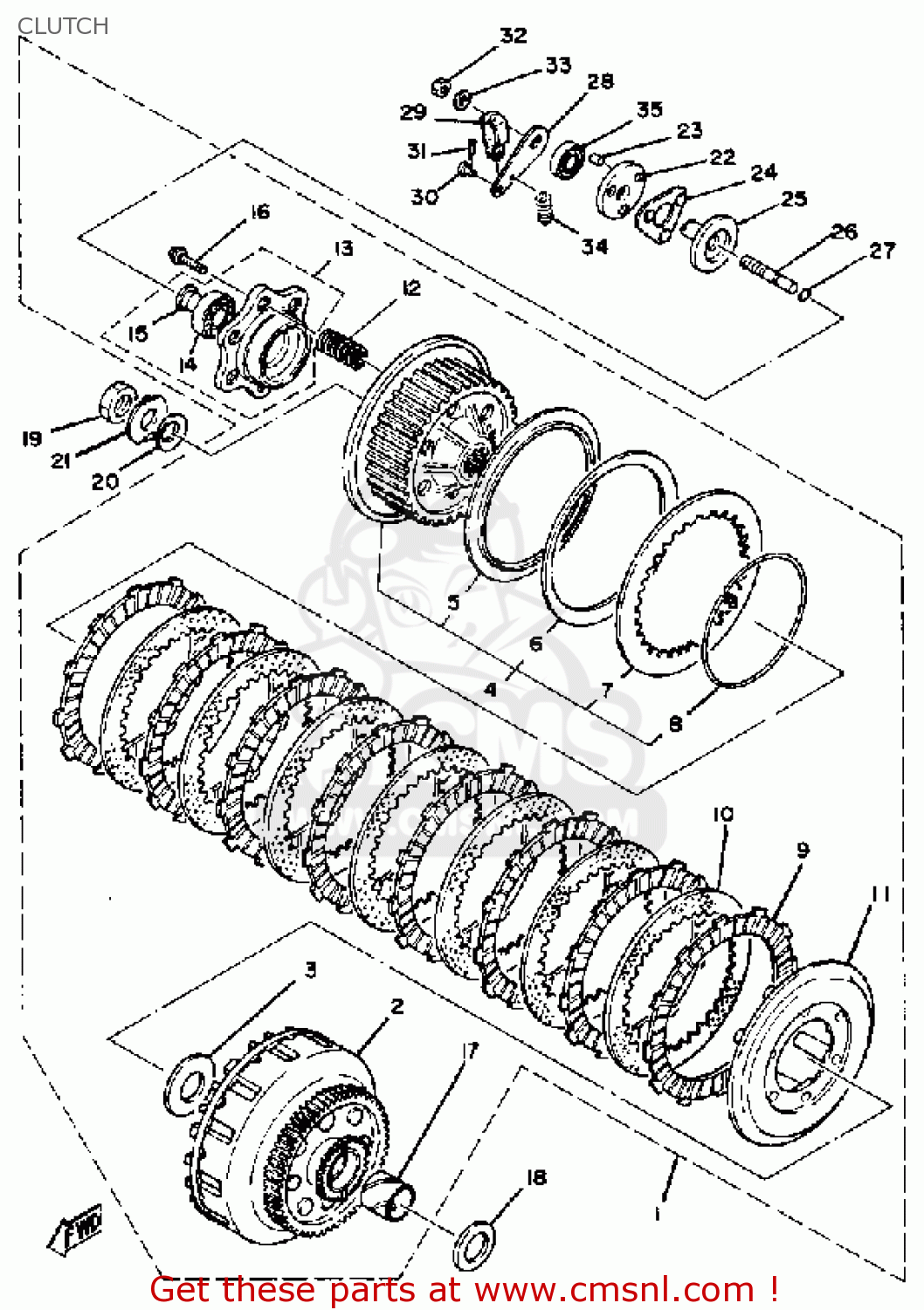

    I recently purchased a 1983 Xj1100, and have been riding it around a bit. I noticed that only once the bike is warmed up, it develops a bit of a rattle. It doesn't have any sort of pattern to it, and sounds a bit random - it is fairly loud though. It increases in frequency with the rpm of the engine, but does not sound like the engine itself is knocking in any way.
    Today while I had the bike warm, I was revving it in neutral to listen to the rattle. At some point something sounded like it caught, and actually stopped the engine while it was near 3000 rpm.
    Once the bike is in gear, the rattle completely goes away and the bike runs awesome.
    I was thinking it could have something to do with the clutch - does anyone here have any ideas?
    Thanks

    Given your description, clutch seems like a good place to start investigating. What is your comfort level tearing into a clutch?

    Clutch hub bearing perhaps?

    Hey guys, thanks for the insight. I think I will order a complete clutch rebuild kit, and the two parts that Franz mentioned if the hub bearing has play. The clutch seems to slip a bit and the bike was sitting for a long time before I purchased it, so I think it may be a good idea to replace everything while I'm in there. I read that some other XJ bikes have a problem where the oil pump drive gear can rattle - does this effect the XJ1100 as well?
