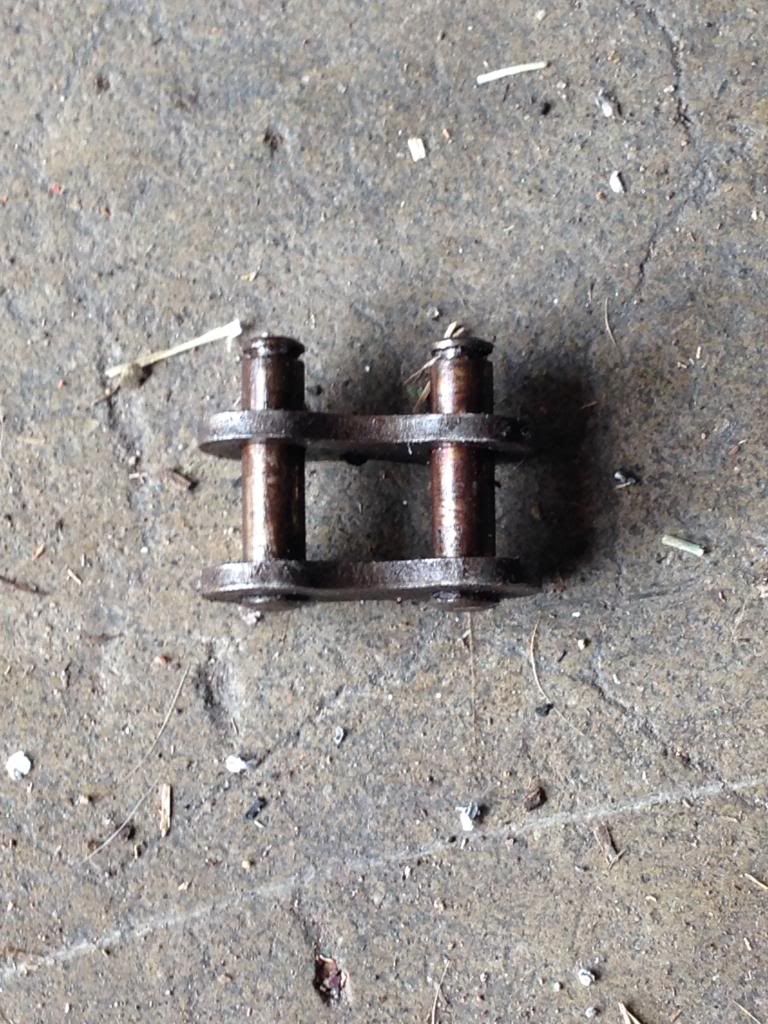

    I was riding home from work on Saturday right and my chain broke. I was trying to accelerate pass a car who was changing lanes without looking. Hit the gas passed the car chain breaks all at once. Pulled the clutch in within a second of the chain breaking costed to the curb no problem. Right. I'm safe and the chains broken. There was about 15 "bikers" at the red light watching this. How many of them do you think stopped. None.
    The master link broke.
    Anyways this is what I don't understand for the life of me is how this happens. Today I took the cover off for the front sprocket to find this intact
    Just like that. Does anyone think this is weird. I DID NOT put the chain on wrong for sure.

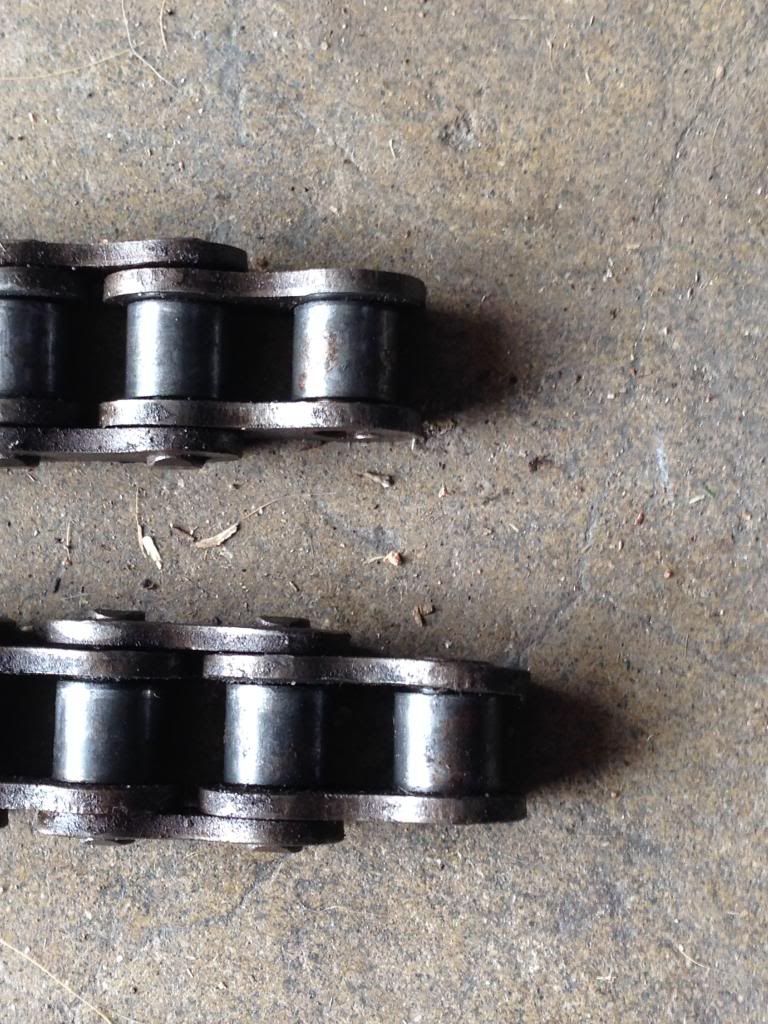

    Here's what the chain looks like.
    I really don't know what to make of this.
    A few months ago i cleaned both sprockets and the chain and adjusted the chain properly following the manual specs.
    Does this sound weird to anyone else?

    I don't have much experience with chains so I'm not sure how common it is for it to break (under normal circumstances). How old is the chain? Is there rust on the pins or does it just look like it in the pic? If it is indeed rusty, that would probably explain why it broke.
  3. bigfitz52
    Good point. I see at least surface-rusted pins on that master link.
    Miles on the bike? 13K in your sig; what's it up to now?
    What exactly broke? A link that disappeared thus thwarting proper forensic examination?
    Have you kept it properly adjusted since you cleaned and lubed it?
    Where is the clip for the master link? You sure you didn't put it on backward (the clip?)
    Moose made a good point. Even a chain that looks fine, if internally rusted, is doomed to failure. Once the bearing surface of even a few pins gets compromised by rust (inside where you can't see it) and then it's doomed.
    The ONLY clue you might get is if it "bleeds red" when you're lubing it; that's a dead giveaway.

    The uppper side-plate on the bottom chain segment (NOT the image of the master link, but the other one) looks bent inwards towards that last (far right) roller...........

    Thanks for the response guys. Rust I dont see any. I went to buy some oil to do an oil change and brought my chain and sprockets after I cleaned everything up. Asked the owner of the shop what he thought of them. He said they looked good and I didn't need anything new.
    The chain was dragging for a few hundred feet as i coasted to find a spot to park. Then it tossed it into the back of a dirty truck and the floor of a dirty garage so the chain looks dirtier than it was.
    Chains maybe 4 yrs old. I guess i need to do a better job of keeping track of everything that I do.
    I just updated my miles on the bike so there's only about a 13100
    Im gonna try and clean it just to see if theres any rust inside of it.
    I'm not going to reuse it or the sprockets they will all be new.
    The chain was adjust properly. What broke???
    I don't no. Its like the master link came apart and magically went back together which doesn't happen.

    i don't see a broken chain. i see a master link that threw a clip. that's why they make riveted chains

    Polocks right I threw a clip.
    Timetoride I am saying that I DID find it assembled. Just like that.
    That's the only reason why I made the post.
    I thought it was weird.
