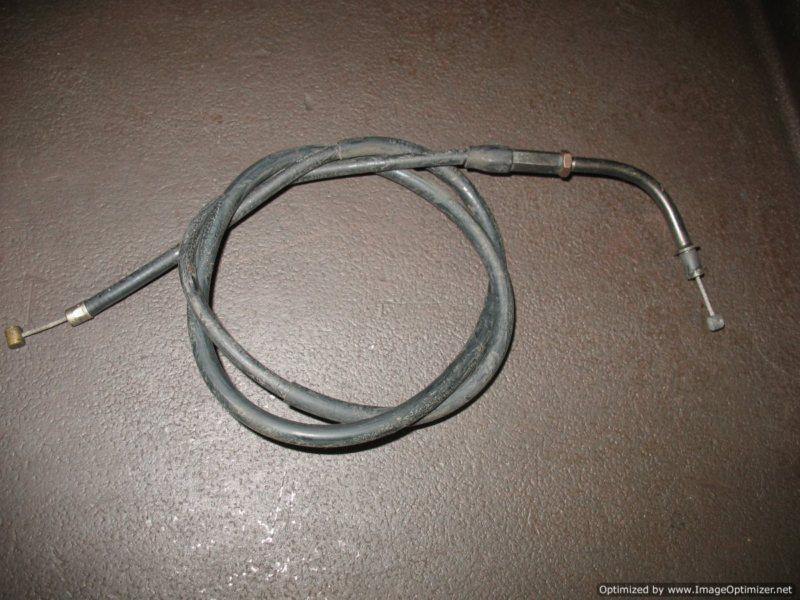

    Also make sure you have play in the throttle cable. There should be an adjuster near the handle bar end of the cable:
    You'll be able to tighten up the slack after you get a vacuum sync done on the carbs.
