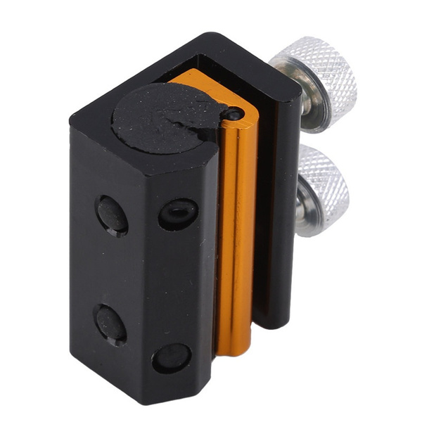

    or buy this tool motorcycle cable lube tool then you use spray lube and it flows the length of the cable in a few seconds. it clamps around the end of cable and there is a little hole in it to insert red tube from spray can. i buy chain/cable lube

    OOOhhhhh you are so smart!!! What kind of oil do you use? WD40? 5w-30?:)
  18. k-moe
    19,697
    6,786
    Either cable lubricant (best) or transmission fluid (good enough).
  19. XJ550H
    3,867
    i like cable lube but you can use motor oil 30wt
    from haynes manual sub funnel for baggie
    vacuum subs for gravity
