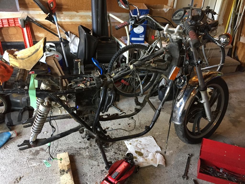

    Alright so I finally got the master link off. It took some persuasion but it popped off. The chain looks like it's okay, just rusty. I've got jug of Varsol to soak it in.
    Also, I drained the engine oil. The drain plug had 1 very small metal flake but was otherwise clean. No water in the oil either.
    Oh, and I pulled the engine. Tomorrow I'll strip the rest of the wiring, airbox, swingarm and shock, and the forks + gauges + headlight.

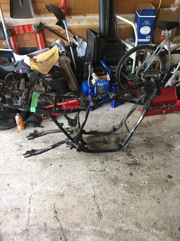

    So I got it down to bare frame today. Hardest part was finding all the ball bearings that fell out of the neck of the fork. That was fun...

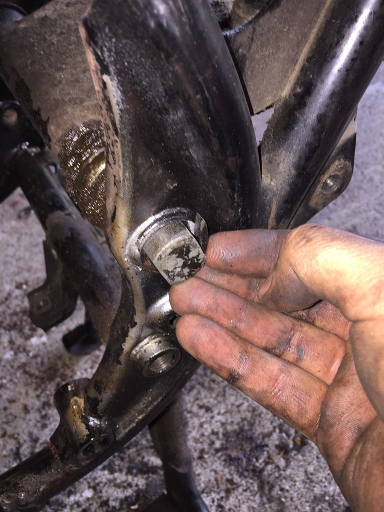

    The only thing I couldn't get off the bike was the swingarm. I took the nut off on the right side but I couldn't get the shaft out. I also noticed a small piece of metal, kind of rounded on the left side the swingarm attached to the other end of the shaft. What is this piece? Looks like it could be the edge of a bushing maybe?
    According to the shop manual I should tap the shaft out with a long rod but it didn't budge. I may not have been hitting it hard enough though. We shall see.

    Long shaft: that shaft is your swing arm shaft. It's probably seized up--- you're gonna have to work at it -- kroil, heat, fuss around, etc.... til you get it out.

    Oh and I got the swingarm out. That shaft was really stuck in there, and I ended up mangling the threaded end. Took 3 of us and a good hour and a half to get it out, a lot of kroil and a ton of heat.
    I'll have to find a replacement. I tried re-threading the shaft with my tap and die set but that was a no go, not enough metal left.

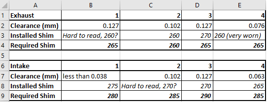

    Alright so I finally checked my valve clearances. I used the "zip-tie" method from this post: http://xjbikes.com/forums/threads/airhead-valve-adjustment-part-2-the-tool-vs-ziptie-w-pics.29209/ but I used a piece of solid 12ga wire. The whole process was pretty easy actually and I'm glad I learned how to do it.
    Clearances are:
    For the two that are hard to read, I should have measured them before putting them back in, and I may do that tomorrow just to make sure but I think I have the correct measurements for those two.
    Do the shims I've listed for what is needed look right? If they're correct then it looks like I'll need to buy 2x 265 shims, 1x 280 shim, 2x 285 sims and 1x 290 shim.
    Another question, the less than 0.038mm shim on the #1 intake side, I don't know what to do there. The smallest feeler gauge I have and can find goes down to 0.038mm / 0.0015" and it won't slide through. I tried pushing it but the thing just bends cause it's so thin. I might have to try again. Advice?

    You're reading the chart wrong. You are putting thicker shims in, which will close up the clearance. You will be going thinner; e.g. exhaust #1 goes from a 260 to a 255.
    AIRHEAD VALVE ADJUSTMENT with Pics
    When you have a clearance that's too tight to get a feeler in, the usual practice is to go two sizes thinner then re-check. The other option is to get the thinnest size and measure using that, then you'll have a shim that you can use whenever you come across a zero-clearance situation.
    Exhaust:
    #1 has 260, needs 255
    #2 has 260, needs 250
    #3 has 270, needs 265
    #4 has 260 (?), needs 250
    Intake:
    #1 has 275, needs 265 then recheck (or buy a thin shim and check for actual clearance)
    #2 has 270(?), needs 265
    #3 has 270, in spec
    #4 has 265, needs 260
    You can swap #1 exhaust into #4 intake, the rest you'll have to get from the shim pool (contact Hogfiddles) or buy (contact Chacal).
    Lightcs1776 and newfrank like this.

    I used to excel Shim Calculator, and just assumed it changed the new shim numbers. Didn't notice that they didn't change so thank you.
  36. k-moe

  42. newfrank
    newfrank Member
    Ontario
    Okay so I went back and measured the #1 Exhaust valve shim and the #2 Intake valve shim with a digital caliper. #1 exhaust was good, #2 intake is actually 265 (not 270). #2 intake has a 265 shim and its clearance is 0.102mm so it needs a 260 shim, correct?
    Exhaust:
    #1 has 260 -> needs 255
    #2 has 260 -> needs 250
    #3 has 270 -> needs 265
    #4 has 260 -> needs 250
    Intake:
    #1 has 275 -> needs 265
    #2 has 265 -> needs 260
    #3 has 270 -> needs 270
    #4 has 265 -> needs 260
  43. k-moe
    19,697
    6,785
    Looks good to me.
    One thing to keep in mind to help you do the math in your head later on (if you don't have a chart handy); round to the hundredths place. The shims sizes are given in hundredths of a millimeter (265 is 2.65 mm).
    Using your #2 intake as an example:
    A 0.10 mm (rounded from 0.102) clearance requires adding 0.05 mm to bring it into spec (0.15 mm clearance).
    Subtract 0.05 mm from the existing shim (increasing the clearance) to find the new shim. 2.65 mm - 0.05 mm = 2.60 mm, which is the size of the required shim (260).
    newfrank likes this.
  44. hogfiddles
    15,067
    5,312
    Frank, you only need;
    2- 250
    1 - 2551
    Follow the steps in the pic....
    Green first,
    Red second,
    Black third
    k-moe, newfrank and Stumplifter like this.
  45. newfrank
    newfrank Member
    Ontario
    Thanks for working through that Dave, I appreciate it.
    Only needing 3 shims seems pretty good to me!
    k-moe likes this.
  46. k-moe
    19,697
    6,785
    I knew there had to be more shims that could be swapped, but couldn't think it through at the time. :)
