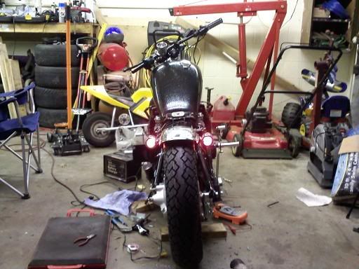

    I got over last night to work on it a little. I'm still brainstorming on exactly what I want for pieces and a look.
    Got the battery mount fabbed. My old man is going to bend me up a cover for it.
    Pulled the gauges and headlight as I'm not using the stock light, and running no gauges or just a small speedo, all depending on money. I like how clean it will be up top without the bulky stock cluster.
    Just for a size comparo I put the bike at ride height. Behind it is a project a friend of mine is getting ready to start in a '77 Goldwing
    Another size comparo, I'm 6'0" 270lbs. I may look a tad big on it, but I don't care. :D

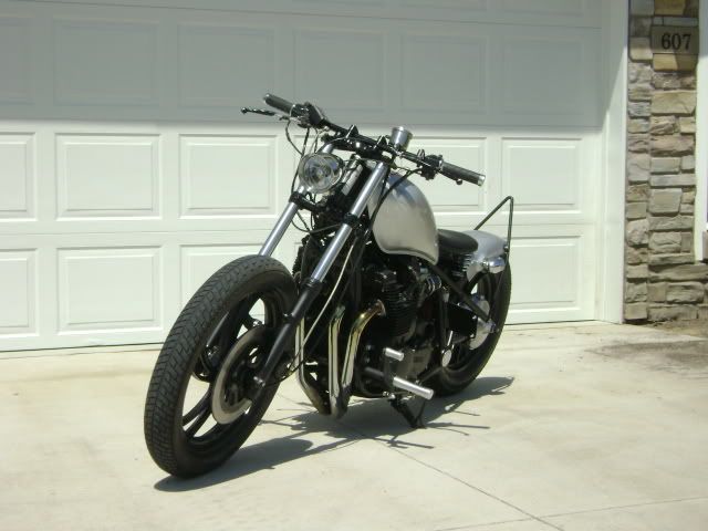

    No SS bolts yet so I'm waiting on those. I also have a sheet of stainless that I will make some inlays with but that will be after I move into our new home which the bike will be done before that. Here's the "low gloss" engine paint I used. I like it minus the fish eyed parts I found which aggrivated me. I'll deal with it later. So other than the SS bolts and me scuffing the fins so there's a contrast, here's the engine.

    I planned on the Satin engine/fork lowers gloss tins/frame/tripples/wheels. Stainless/chrome touches here and there. When I build the sissy bar it will go out for chrome.
