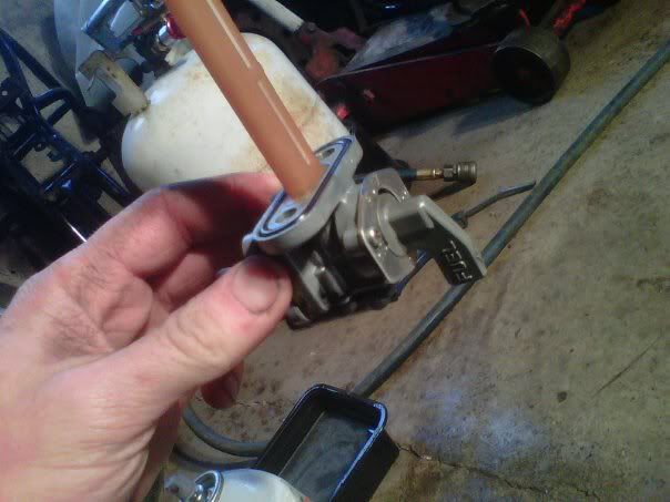

    *Update*

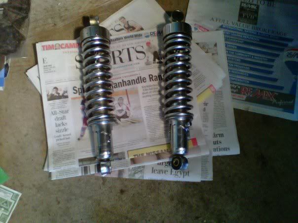

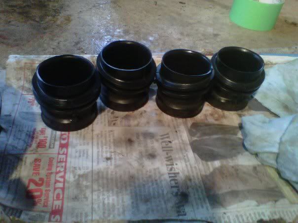

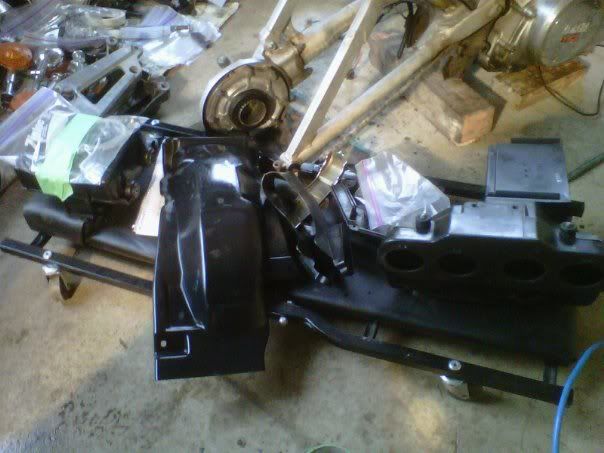

    Been getting a bunch of stuff cleaned up, waiting on 1 valve shim and painting parts to start putting it back together. I've thrown a couple shots.
    Rebuilt fuel valve
    Intake Boots
    Fender, Airbox and Battery Box
    Rear Shocks

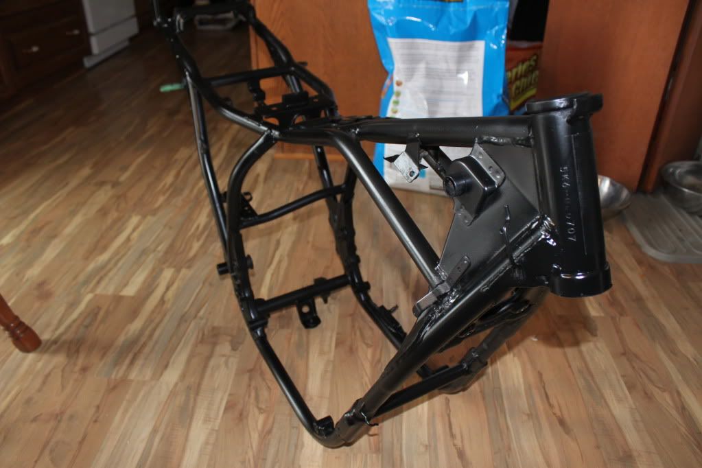

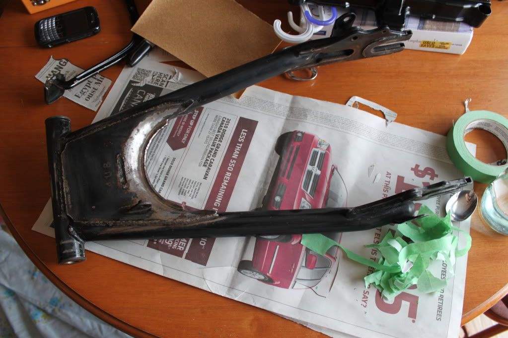

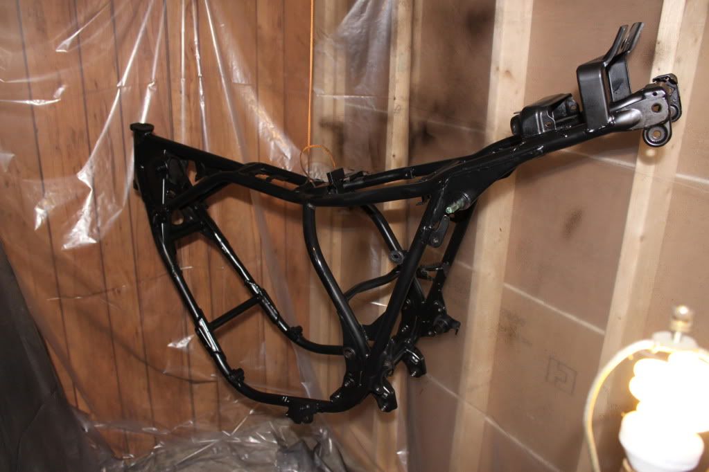

    Finally got some time off this week to start painting. Really should have invested in a sandblaster, but about 5 hours of hand-sanding later and here we go! Waiting for the paint to cure on the valve cover so I can polish up the ribs. Got the swingarm and centre stand done but ran out of paint before I could finish the frame.
    Pre-paint
    First 2 coats

    Those look like the original shocks. At that mileage, if they are, they are most certainly all done. I'd replace 'em. (My '83 550 had 7100 miles when I got it and the shocks were toast.)

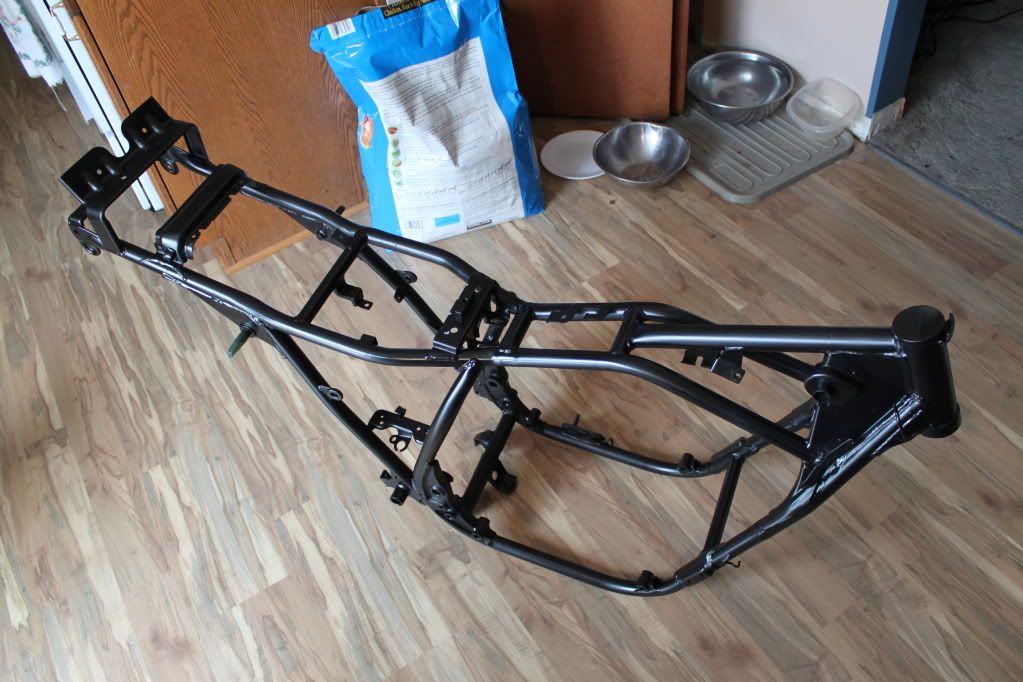

    Finished the frame last night before work!!

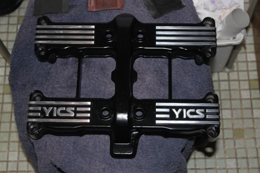

    Finished up the valve cover tonight. Polished up the ribs and logo, I think it turned out pretty well considering it's really my first experience with spray paint haha!

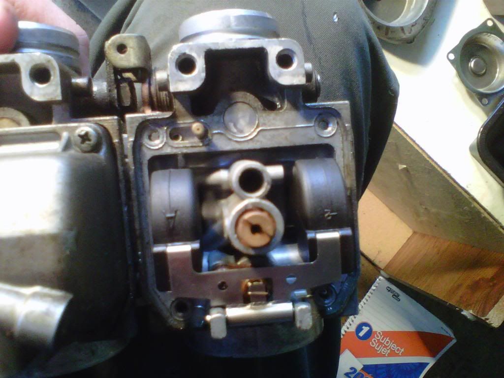

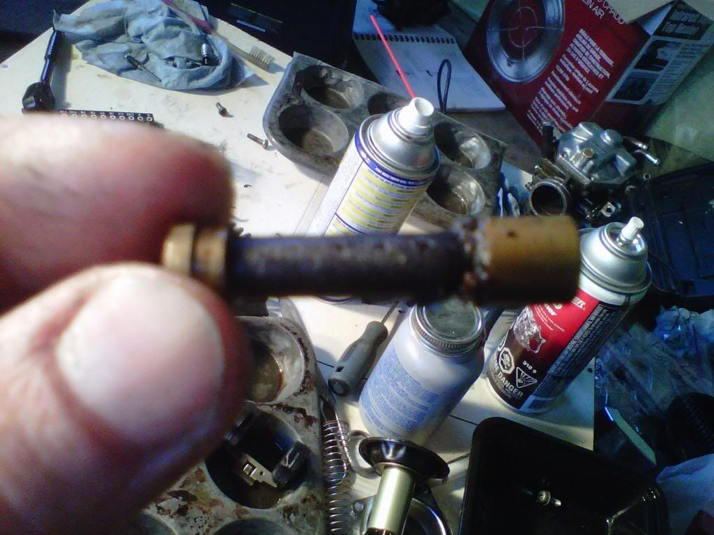

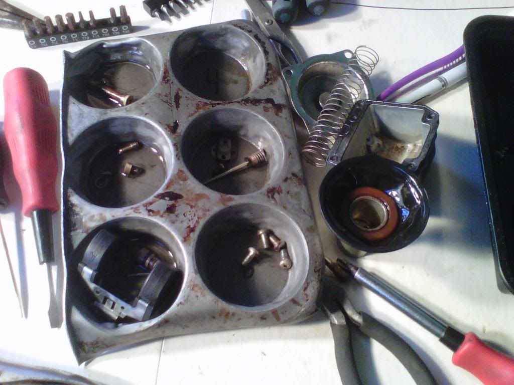

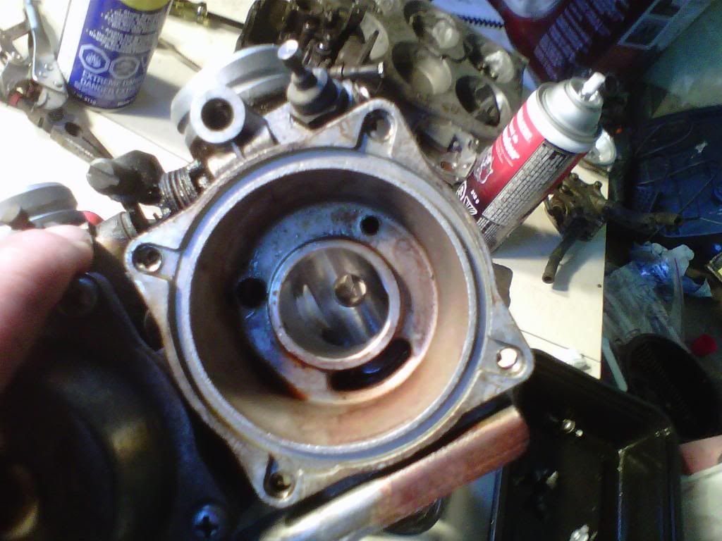

    Yesterday was carb day. Took me forever to get the float pins out of the bottom end. Anyone have a trick for them? Got through the first 2 before I had to go to work, hoping to get to the rest tomorrow. Sorry about the poor quality but my camera died a couple weeks ago and I'm using my blackberry.
    Bottom end
    Jets soaking
    Top end
    30 years of grime most likely
