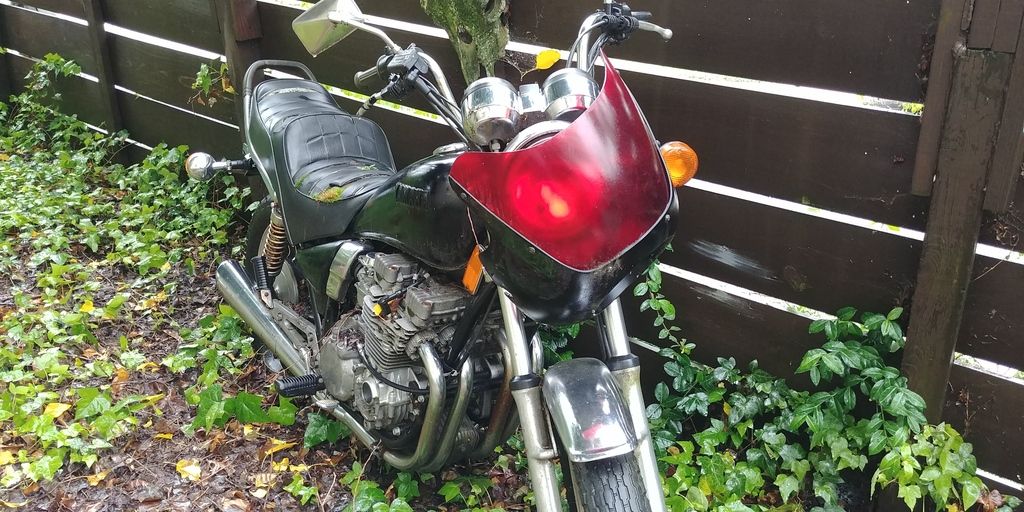

    This is my Maxim and from what I've read on here, Len is about to become my new best friend..

    Ooh, custom seat cushion!
    Len is your friend.:)
  6. k-moe
    19,697
    6,784
    I see that it comes with the Woodland Brushfire accessory kit.

    I think that's an early version of the Realtree cammo pattern.

    Nitvid, get her out of that yard cleaned up and in the sunlight, she will look better. 16K miles is not bad and all in all she looks okay. Should be a fun project for you.

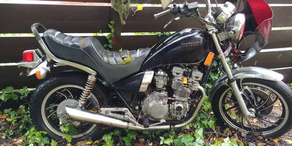

    I have a stock seat that looks a lot better than that I might end up selling. Along with the snap in side covers if they're scratched beyond fixing. Good luck with your build! You said the bike was rideable after the crash? So I'm guessing the frame isn't bent or any issues there?

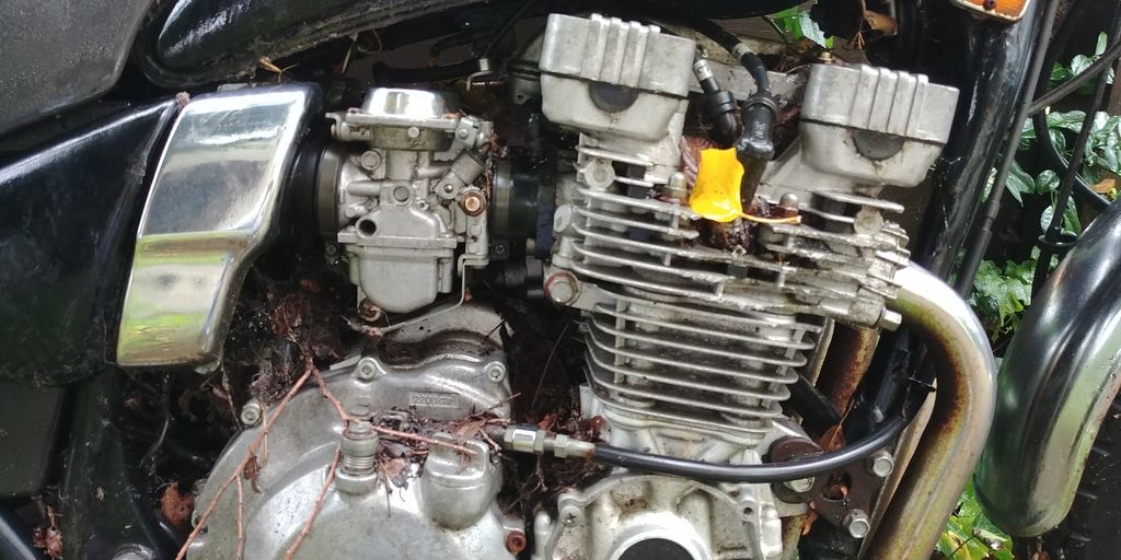

    I thought about rebuilding the carbs, or having them rebuilt anyway by a local shop with a good rep, since it hasn't run in quite some time. do you think a good cleaning is all that I would need? I'd be up for that challenge.... maybe...

    looks like your missing a motor side cover and blinker.
    you can start with a good cleaning but breaking the rack and replacing the throttle shaft seals and fuel line o rings is the recomended method.
    so you do not have to do it twice.
    xj4ever has all the correct parts you will need and the throttle shaft seals

    For that kind of price, I wouldn't trust those kits as far as I could throw them.......and I BET that doesn't include the fuel supply rings, throttle shaft seals, mixture screw o-rings, etc....and I bet the don't even take the rack apart. I've even seen some shops where they just pull the bowl, spray some cleaner in the carbs' general direction and say it's been cleaned and rebuilt.
    I just did a rack for a fellow here that 'had it rebuilt at a shop"....well-- the t-shaft seals were hard and trashed, the fuel supply rings were tittle, the supply T was so loose it rattled, the needle tips were malformed from sitting, the carb 4 body was cracked through from hammering to remove the bowl, etc.....
    When I do a rack, it will come back to you as clean as it left the factory, and set back to factor initial settings ready to dial in for YOUR bike. You can see other pics if you search through the forums
