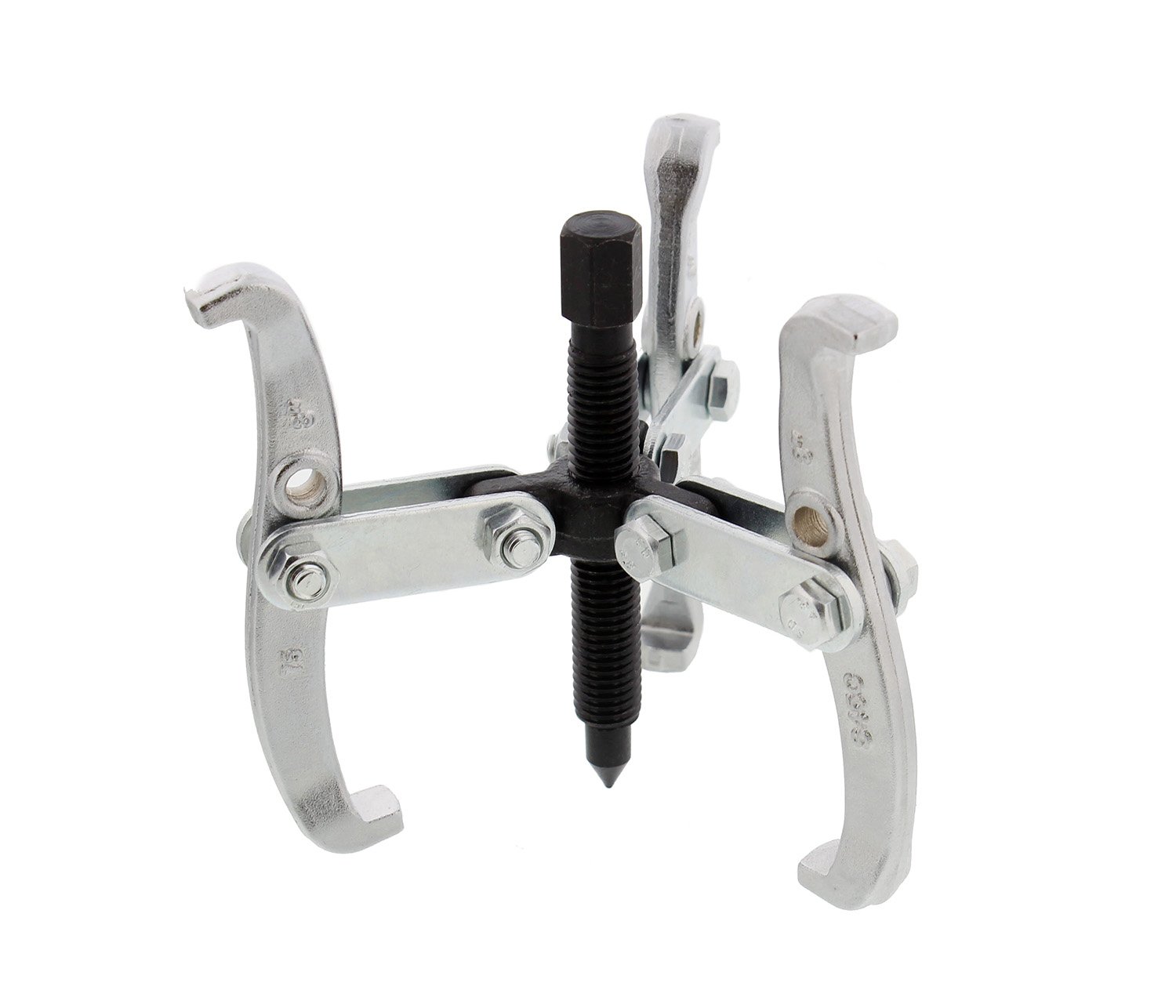

    Just got to figure out what size puller is required (jaw width?). Is it at least 85mm, which is the distance across the diameter of two of the three flanges?
    Regards.
  40. k-moe
    19,697
    6,787
    My three-jaw puller is adjustable for width.
    Looks like this:
