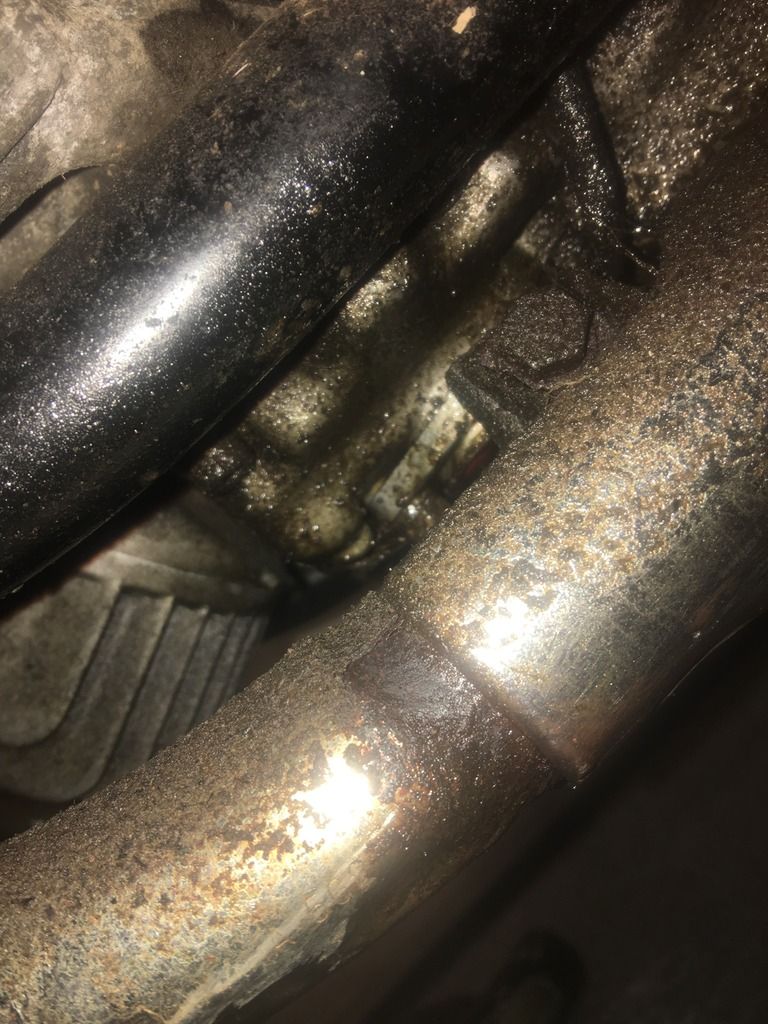

  17. k-moe
    19,697
    6,786
    You won't find an oil leak coming from the exhaust ports. It's somewhere else. Leave the exhaust be for now.
    Degrease the engine, let it dry, Dust the area where you see the evidence of a leak with talcum powder. Run the engine and watch for where the talc begins to darken from oil.
    Odds oare it's coming from the valve cover gasket, or the cam chain tensioner gasket. A slow leak can cause the oil to weep around and show up quite far from where the leak actually is.

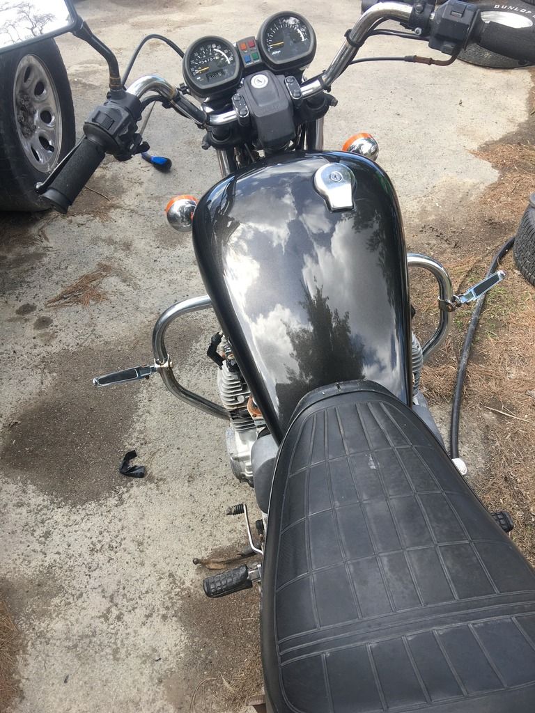

  19. Alex Rodriguez
    Alex Rodriguez Member
    Spencer ny
    My bike has 32755 on it and yes it does I'm signed up for it

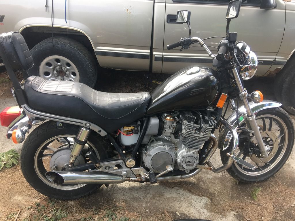

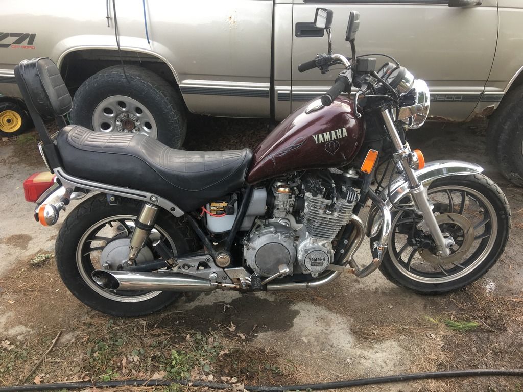

  20. Alex Rodriguez
    Spencer ny

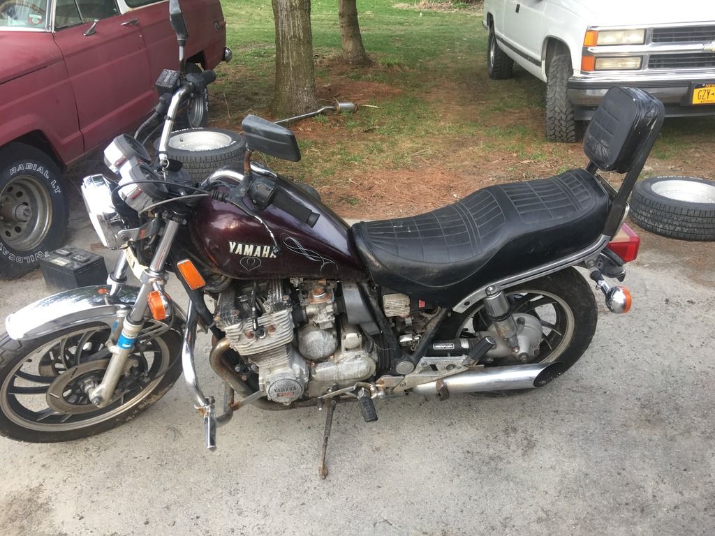

    Before I painted the tank
    craiygxj and Dadoseven like this.

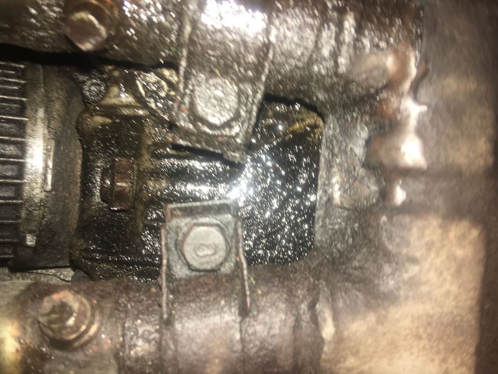

  21. Alex Rodriguez
    Spencer ny
    Here is a picture of the leak it's goes further back too
  22. Timbox
    2,801
    979
    Wisconsin, Tomah
    Oh ya, need to de grease that engine and then work from there. Really glad to hear that you have a class in your area. Really good class, I have taken it more then once, as time marches on things change. That class changes with it and brings all the good riding stills with it.

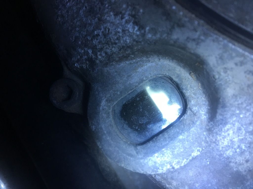

  25. Alex Rodriguez
    Spencer ny
    Now back to the oil level here is a pic of the peep hole
  26. Timbox
    2,801
    979
    Wisconsin, Tomah
    Just for a future thing, hit those header bolts with some solvent. Down the road you may want them off. At least that will give the solvent lots of time to work. If you have time get some de greaser and get her all nice and clean. Then start her up with some powder on her and see if you can find the oil leak. With all that older leaked oil, it will be really hard to find the leak. Keep working on her, you will find it.

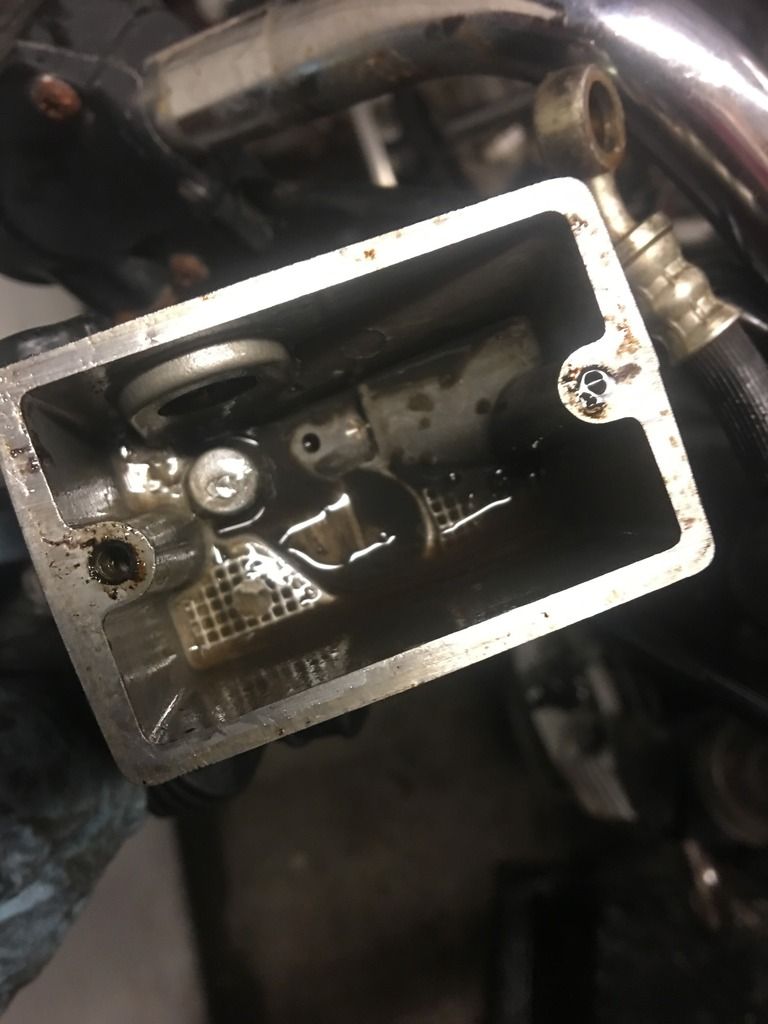

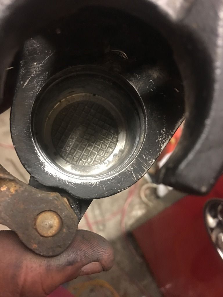

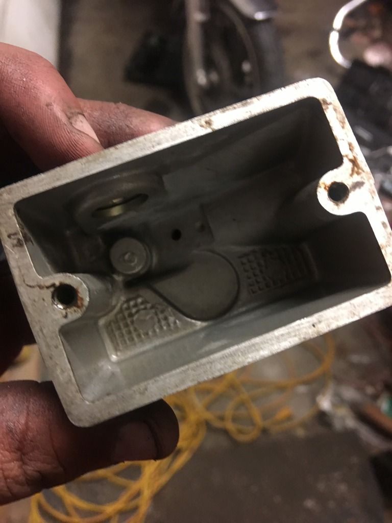

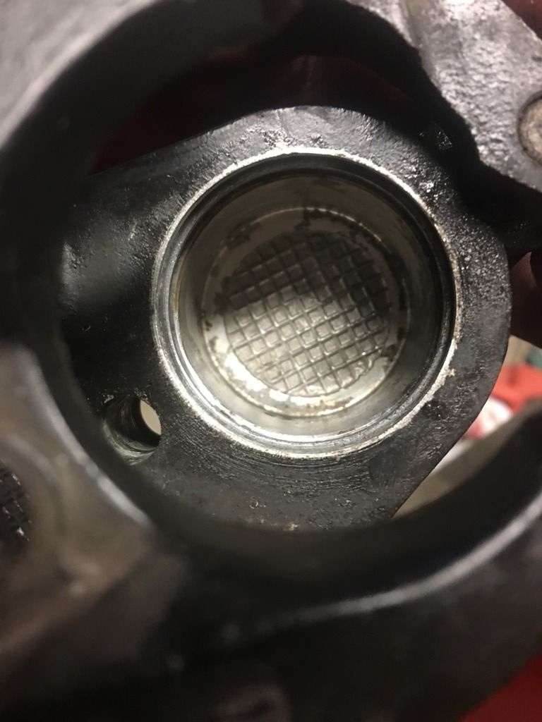

  36. Alex Rodriguez
    Spencer ny
    So I started working on some of the safety things on my bike
    M/C before
    After
    Front left
    craiygxj likes this.
  37. k-moe
    19,697
    6,786
    New seals as well as the cleaning?
  38. Alex Rodriguez
    Spencer ny
    Yes all new seals and everything now just need to bleed them

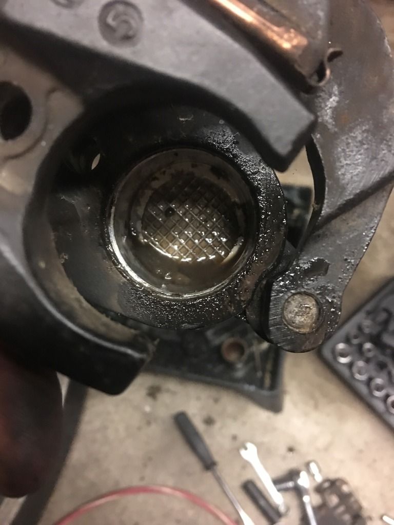

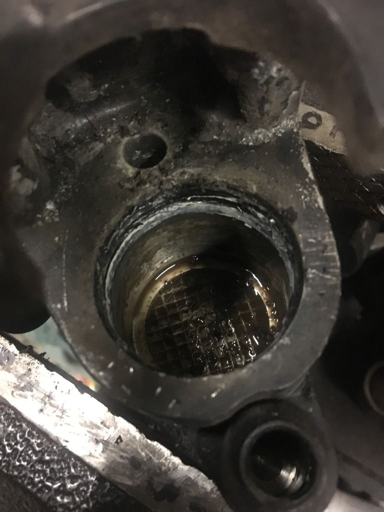

  39. Alex Rodriguez
    Spencer ny
    Alright need some help!
    So I reverse bled the brakes after the rebuild but the calipers arnt clamping down the are close but seem to have stopped what do I do
  40. Timbox
    2,801
    979
    Wisconsin, Tomah
    Is the piston moving out when you squeeze the handle? Are you doing this with the caliper on the wheel and brakes installed or just trying to see if it is moving? How does the handle feel when you compress it to the bar?
  41. Alex Rodriguez
    Spencer ny
    I can't tell if piston is moving caliper is on the wheel and brakes are installed and the handle doesn't feel bad it's not loose but it's not lock the wheels up tight
  42. Alex Rodriguez
    Spencer ny
    When I squeeze the handle the cylinder moves out but when I let go it comes back in
    Is there a vent that might be clogged?
  43. k-moe
    19,697
    6,786
    It's supposed to do that.
    When you had the caliper apart, did you clean and polish the sliding pins (these get grease) and the brake pad retaining pin (no grease), along with the steel shims that the two caliper halves ride on?
  44. Alex Rodriguez
    Spencer ny
    Haha yea that was a dumb thing to say yes I did lube those pins
    What I meant was unlike a car where you pump the pedal until it gets to the rotor this is just like stuck it won't continue to go any more
  45. k-moe
    19,697
    6,786
    There's still air in the lines. Tie the brake lever back against the bar and do the following.
    9. You aren't done yet. There will still be some air in the system. The next step cures that, no matter what method you use to fill and bleed the system.
    10. Use a vibratory sander (no sanding pad) and slowly run it along the brake lines, calipers, and distribution block from bottom to top. This will move any remaining air bubbles up into the master cylinder. Tap (or vibrate) the master cylinder to get the air bubbles to come out of the return hole. This process can also be done with a box-end wrench or other simmilar tool, and tapping the calipers and lines (it just takes longer).
    11. Do one final bleed normally, just to be certain that the calipers are fully bled.
