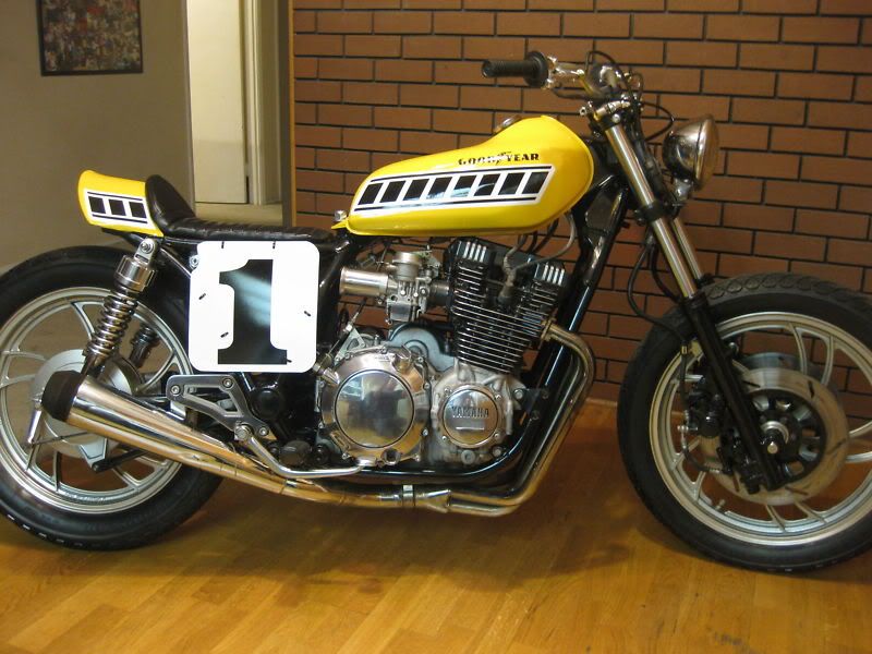

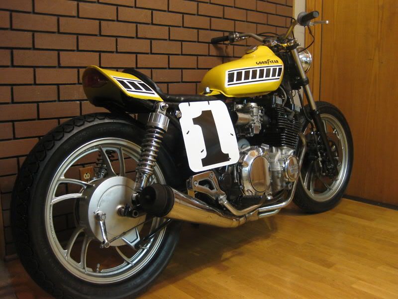

  20. TIMEtoRIDE
    Check out a Seca 750 - Kenny Roberts style
    (looks like velocity stacks - sold for $3,500)
