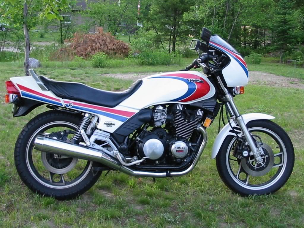

    Hello, all you 900 aficionados, these 4 lugs on the front of the tank, are they for fixing a faring? & if so & I am staying buff naked, can I just give them a new zip code? Wiz.
  39. Hillsy
    Hillsy Member
    634
    12
    The nekkid versions had oil cooler shrouds that mounted there (one on either side).
    And I think the half fairing versions mounted the fairing there (?)
  40. RickCoMatic
    No.
    Those ate the Mounting Points for Plastic "Air Scoops"
    OEM Air Soops are no longer available.
    Being Mounted in those "Ears" with Rubber Grommets left them susceptible to falling off.
    The Air Scoop was of an elongated-triangular design.
    Deflector Panels within the Scoop directed On-rushing Air entering the scoop to the Canyon in the Head where the Spark Plugs fit.
    http://cgi.ebay.com/ebaymotors/1983-YAM ... 500wt_1182
  41. TIMEtoRIDE
    It won't look right without something there.

    The fuel tank on my XJ has those 4 lugs. They don't do anything. You can't see them with the fairing. The frame mounted fairing is on a mounting bracket, and some distance away from the tank. Here's a rather poor picture. The light wasn't very good today, and my phone camera doesn't have a flash.
