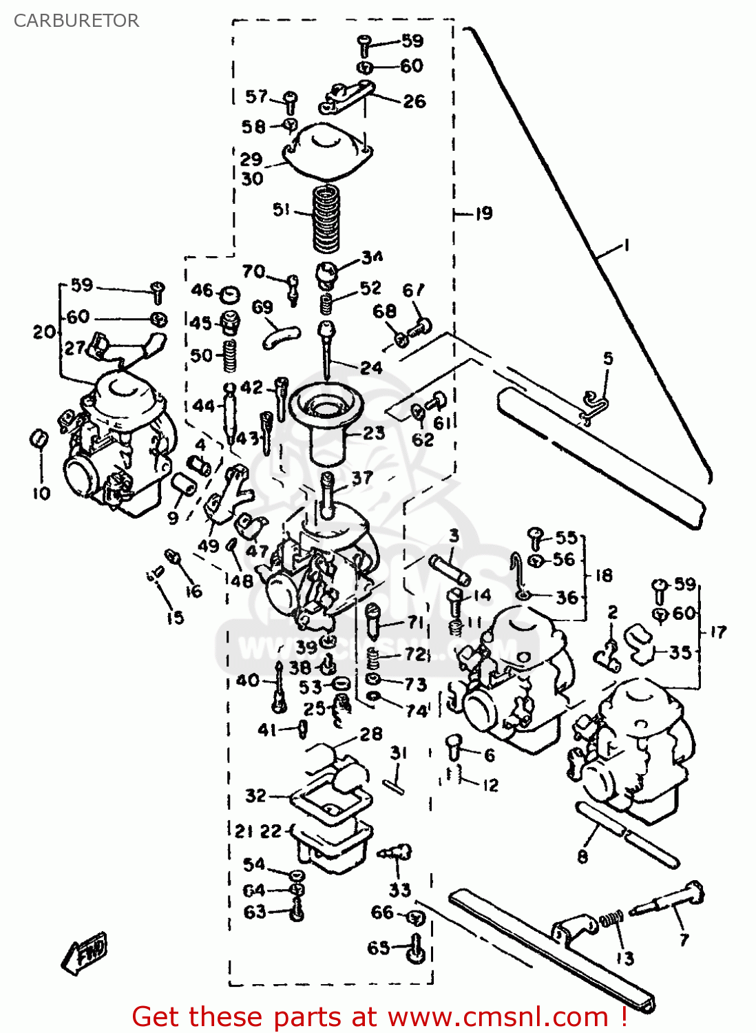

    Another post to quickly ask if there should be this much play on the nylon washers or are mine just worn off and if the case which should i change to make sure i get the butterfly valve centered as it is.
    I have this issue on carb 2 and 3 but not on carb 1 and 4

    I tried to look for it there, but on the exploded view of the carbs I can't find the washer number...
