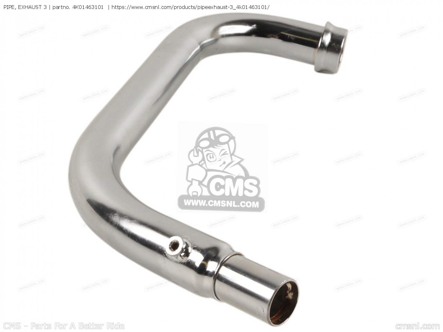

    Hello all , yip just checked as i am restoring a STD 4ko collector just now.
    Std 4K0 collector ID is 33 mm reduced down to 28 mm ID with crush gaskets, to 28 mm OD taper end of STD 4k0 down pipes , marving collector accepts 28mm and no need for expensive gaskets , high temp silicone and then clamped up tight, just like collector for XJR 1300 from black widow.

    Hi and just an update I did purchase the Marvin collector box and have fitted it but I did need to heat up the number 2 pipe and bend it on the collector box to make it fit as it did not line up with the downpipe and you don't need the crush gaskets will take a few photos and post them when I get a chance and Steve my pipes also have drain bolts on them and I am pretty sure that they are stamped 4KO on the downpipes.

    From new, my 1980 4K0 (UK) XJ650 header pipes didn't have the emission analysis sample points (drain bolts).
    In 1990, the header pipes were replaced, they were ordered & supplied by a Yamaha dealer. They are genuine parts but this time they had the sample points on them but as above, stamped 4K0. I've often wondered if these are from a US spec. (Seca) bike where exhaust emission regulations may apply.

    This is a photo of a Maxim header against the Marving 4-2 collector box for a 4K0 model, it doesn't fit.
    I now understand that the Maxims have 2 x 2-1 silencers with a balance pipe between the two sides.
    Whilst the header pipes for a Maxim may appear to be the same as those for a 4K0 model, the OD (28mm) to the 4-2 collector box or Maxim 2 x 2 -1 silencers isn't.

    Just to back Dave up my downpipes ends are tapered to fit the Marvin collector box.

    Last year, I had to have one of the four header pipes repaired on my 4K0 (UK) XJ650.
    The repair was having a length of 28mm OD tube welded on to replace the corroded and snapped off section which enters the 4-2 collector box.
    With this in mind, I wonder if 4H7 headers could be modified in the same manner to fit a 4-2 collector box.
    If this had not been successful, then after a lot of research the conclusion I came to was that I'd fit a Marving 4-1 racing system.
