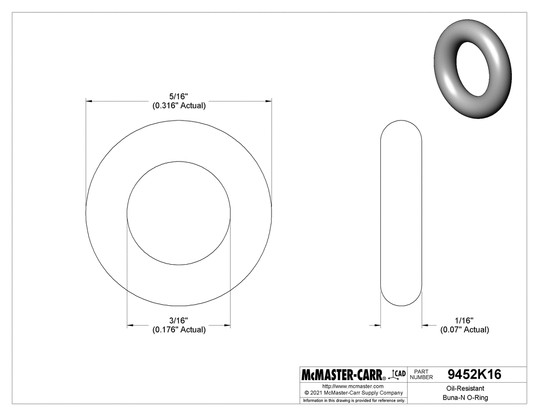

    These little Enrichment (Aka Choke) Plunger Caps (Yamaha #3J3-14968-00-00) for the HSC34 Carbs are NLA so here's a drawing with dimensions if you want make your own.
    I turned mine on the lathe and they work great. I don't think 3d printing would be strong enough, tho happy to supply a STL if someone wants to try.
    Also not opposed to making a few more of these out of aluminum, if there is any interest.. Let me know & Enjoy!
    [​IMG] 1

    In the image directly above this post, you can see the HSC34 Idle Screw bore, (behind the choke plunger). Like most carbs from this era the idle screws were plugged to prevent "tampering". If you drill and yank the plugs on these HSC34 carbs, the bore points straight up & is open to the elements.. water dirt and debris can fall in & will stay there causing havoc.. So, to mitigate the issue I drew up these Idle Screw Plugs that are a snug o-ring fit into the idle screw bores & removable without tools. They use McMaster o-ring #9452K16. I haven't had time to actually turn these on the lathe yet.. sometime soon tho, since I dont want rain water or dirt getting down into those bores come spring.
    Also happy to share a STL or whatever people want if someone wants to try 3d printing this... I assume a plastic print would eventually snap off in the bore, which is why I'll make mine out of aluminum & will post photos when able!

    For anyone who cares, this O-ring (Yamaha #2G2-W0044-00-00) is NLA from Yamaha, & serves as a dust shield & vibration damper for the pivoting "2G2" caliper described above...Standard equipment on the XS850 "Special" models and other bikes with the 2G2 caliper (also listed above). This is a basic metric o-ring, readily available from amazon, etc. OD 21mm, ID 14mm, Thickness 3.5mm.
